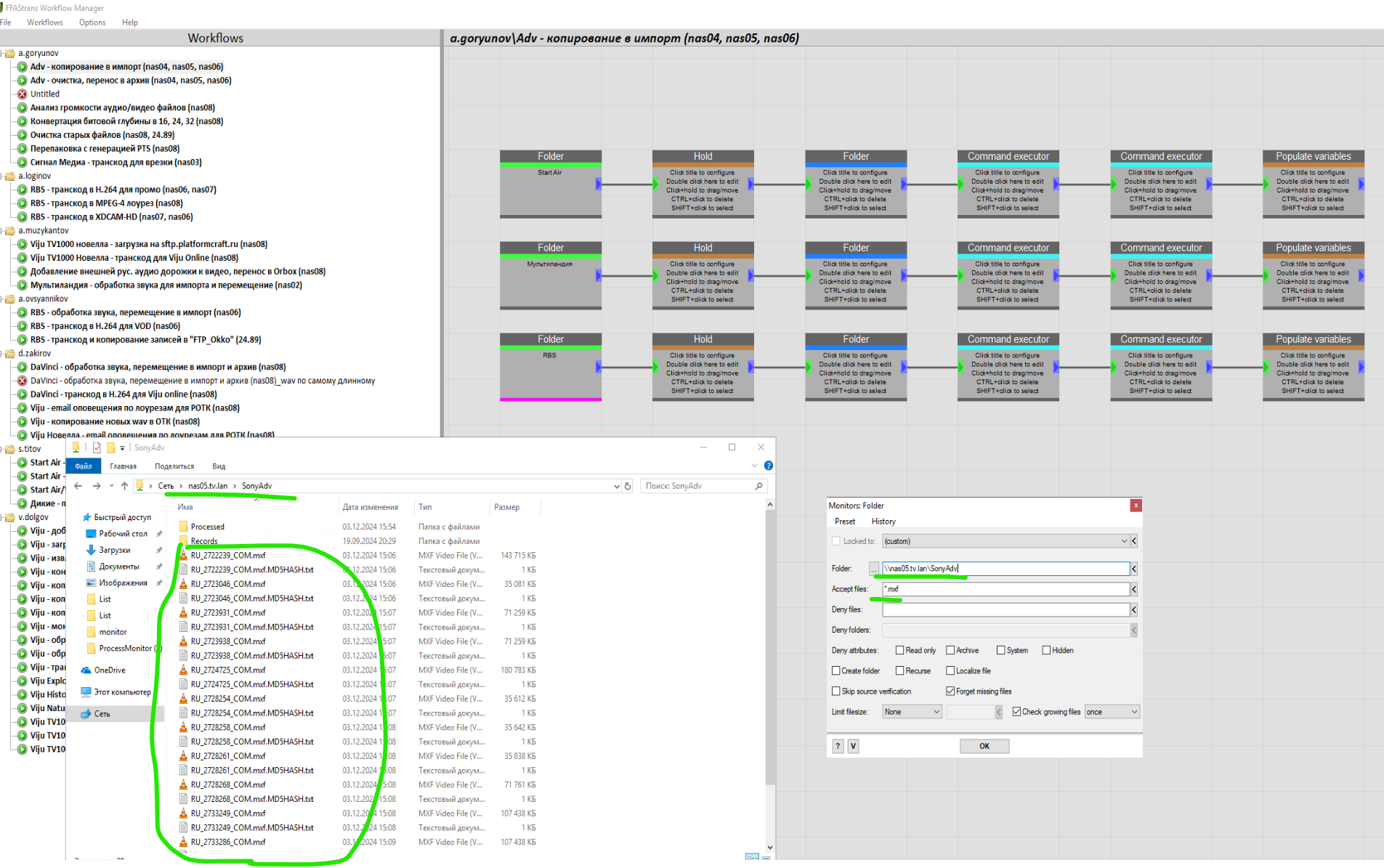

Folder monitor sometimes stops seeing files in directory:
Stopping/shutting down workflow does not help.
Clearing folder monitor history - does not help.
Removing files from the directory on sleep timer time - does not help.
The same problem occurred on FFAStrans v1.3.1, then I solved it by recreating the workflow from scratch. Exporting and re-importing workflow did not help as far as I remember.

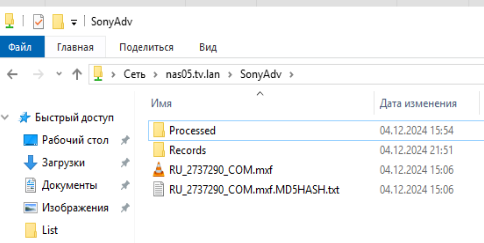

Here's what I've been doing:

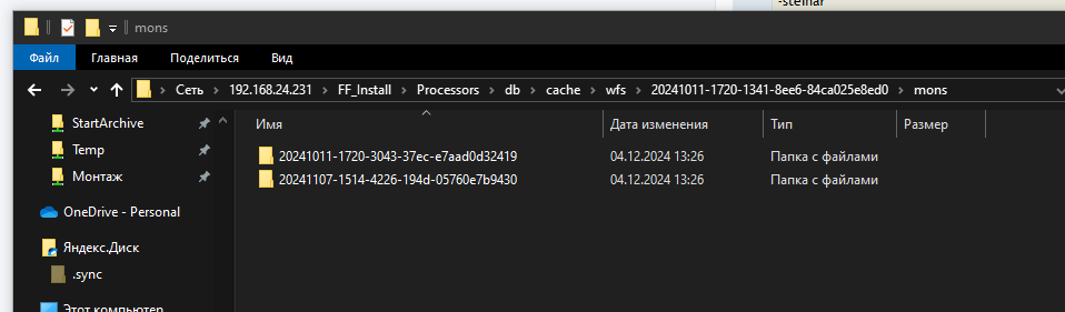

I checked the directory '\\\192.168.24.231\FF_Install\Processors\db\cache\wfs\20241011-1720-1341-8ee6-84ca025e8ed0\mons' - it had three subfolders with the id's of each monitor folders.
I found an unreadable subfolder '\\192.168.24.231\FF_Install\Processors\db\cache\wfs\20241011-1720-1720-1341-8ee6-84ca025e8ed0\mons\20241107-1516-3717-42ae-3bec17cdfae1' with subfolder '\i'.
I restarted server 24.231 to resolve the folder blocking issue as restarting FF services didn't help. After the reboot there was no inaccessible folder there.
That didn't solve the problem.
Next I did:
Cleared the folder monitor cache for '\\nas05.tv.lan\SonyAdv' (node: 20241107-1516-3717-42ae-3bec17cdfae1) - didn't help;
I tried “Skip source verification” - no help;
Stopped/started worflow - no help;
Disabling/enabling workflow - didn't help.
At the moment there is only one *.mxf file left in the monitored directory, which is not picked up by the monitor. It is not blocked by anything - I can move it freely and according to Process Monitor there are no accesses to it (I checked on the server where the *.mxf file is stored). Processors\db\cache\wfs\20241011-1720-1341-8ee6-84ca025e8ed0\mons: Here are logs from 'Processors\db\cache\def_log': The directory '\\nas05.tv.lan\SonyAdv' doesn't seem to be monitored by anything else according to logs.

Folder of interest is the missing subfolder for the SonyAdv Folder in db\cache\wfs\20241011-1720-1341-8ee6-84ca025e8ed0:
This folder should be created by the same process that runs for the other 2 watchfolders in this workflow, so the process/script itself runs. One of the first things the def_runner script does is to create the folder if it's not there, obviously this fails.
Can you create this folder manually?
You can also try to just copy/duplicate the workflow so it gets a new GUID and therefore all the folders in mons dir are recreated. When this copy is startet, the 3 subdirectories in cache/wfs/%workflowguid% must be created - if not you can stop at this point and let us know.
20241107-1516-3717-42ae-3bec17cdfae1Can you create this folder manually?

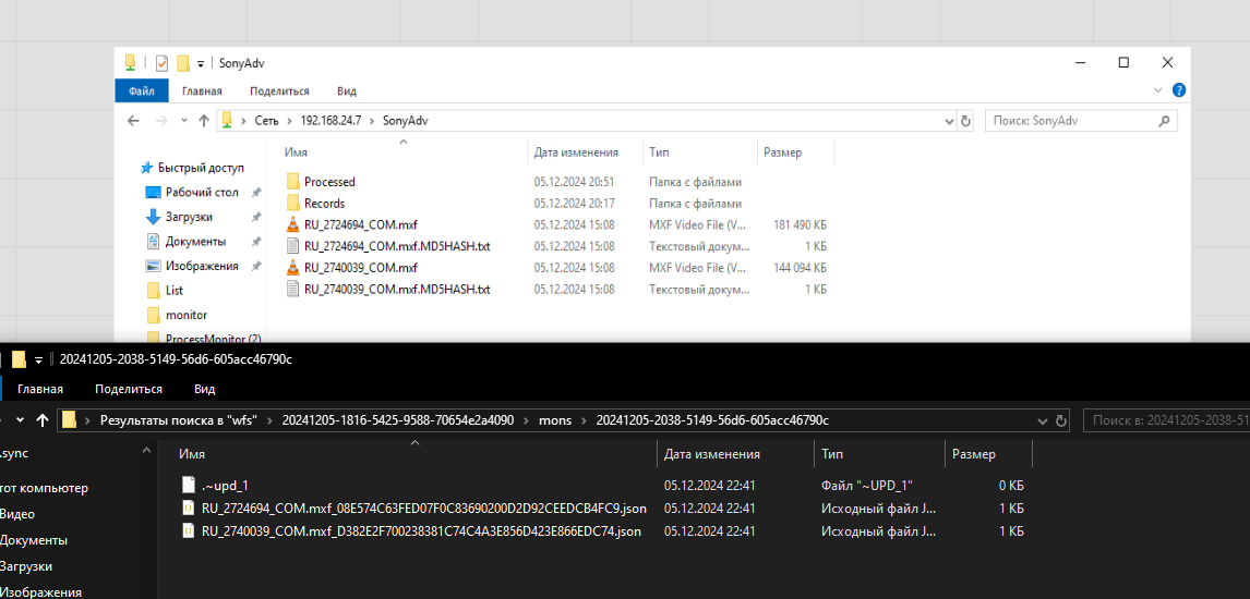

But today is a new day and a new stack of unprocessed files
Duplicated Worflow (to change ID), recreated monitor processor (to change ID), tried clearing the cache, Stopped and turned off this worflow, Tried to set a specific server to execute this wokrflow - no luck.

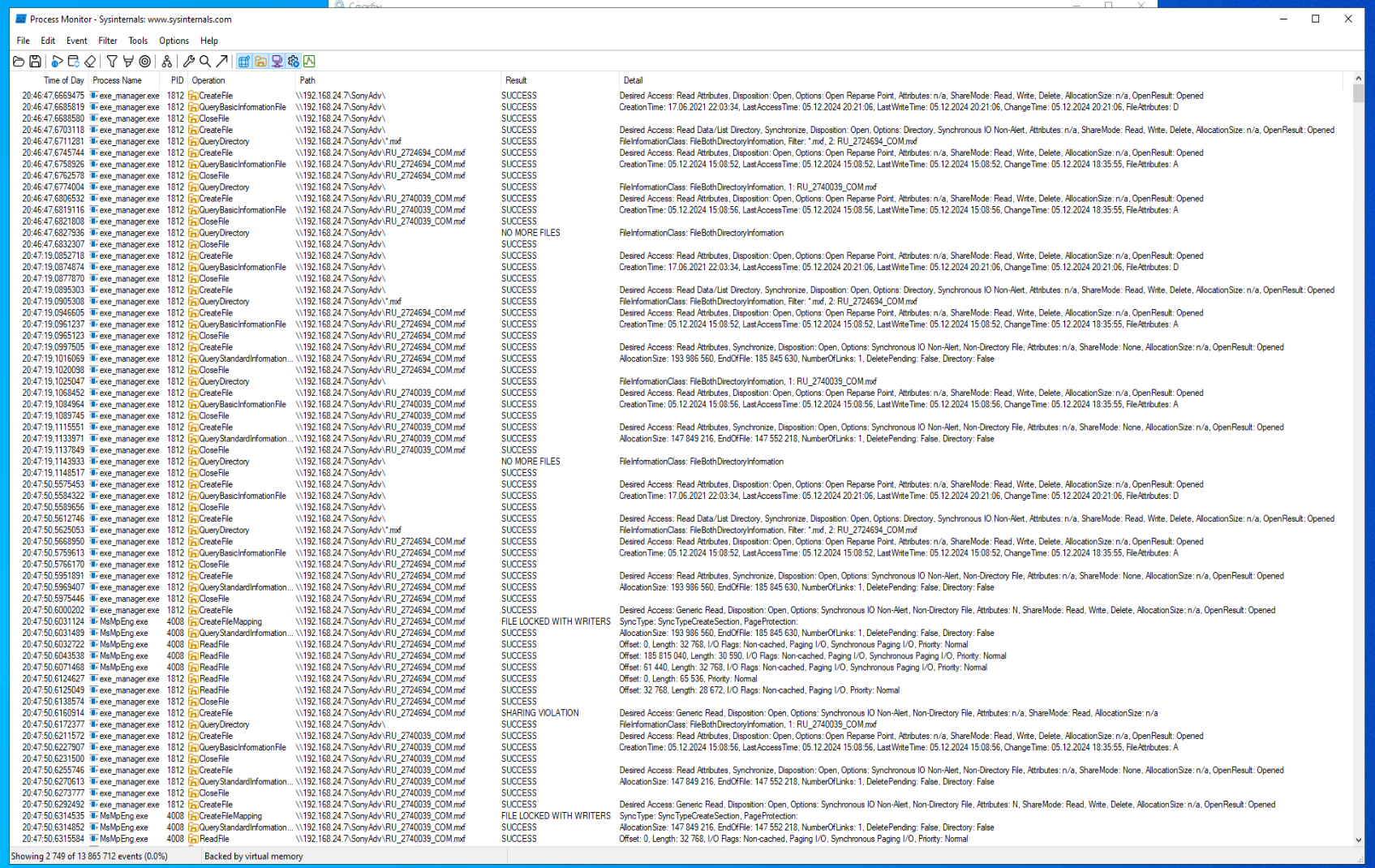

I turned off the workflow. Started Process Monitor on the servers (SRV043 - the only one designated server for this worflow) that are assigned to execute this workflow and started the workflow: And it looks like it's trying to do something with these mxf's but to no avail. What do you think that means?
While logging, I made a copy of one of these mxf and put it in the same directory as “TEST6.mxf" - it processed fine by the workflow.
Here is the log file - https://dropmefiles.com/MFNVP
The workflow itself and its archive:
Sorry but i recreate the wokflow under new ID, but here is the archive of the old on:admin wrote: Thu Dec 05, 2024 6:11 pm Could you please send the current workflow id 20241011-1720-1341-8ee6-84ca025e8ed0 that does not work? AND the backup \db\configs\archive\workflows\20241011-1720-1341-8ee6-84ca025e8ed0_bac.json. We just need to make sure there is nothing odd with the workflow.
Thank you very much, I will definitely try this tomorrow. Do I also need to enable extra_log in FF for it?admin wrote: Thu Dec 05, 2024 6:11 pm I'm also attaching a modified version of def_runner.a3x for you to replace the existing in \processors. Just rename the old and replace. Please stop the workflow before replacing. This modified one will add extra logs that might shed some light on what's going on within ffastrans.
Thanks for helping debugging this issue!

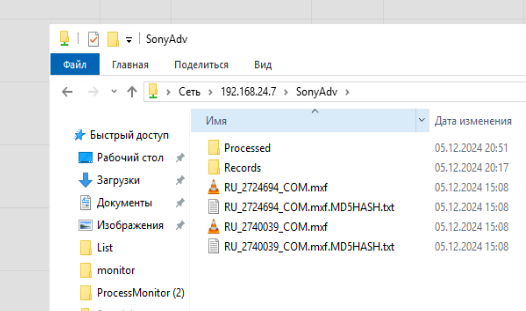

UPD: you know what? After I wrote this post I tried turning on 'skip source verification' - the files were processed and moved successfully from the folder
Earlyer I tried to see if anything uses these mxf files on \\192.168.24.7\SonyAdv (\\nas05.tv.lan\SonyAdv) - nothing found. I also tried moving them from this folder - they moved freely.
Could this be a false positive on locked file state? Or some kind of self lock by FF?

Coming to your procmon logs:
Just like in the last procmon you sent that was about the locked monitor jsons, we again see that msmpeng.exe is definitely in the game (should be Defender). Also, we see all operations that our def_runner script does up to the point where it finally tries to "open the file for "shared reading". This final check ends up in a "SHARING VIOLATION", which just means something thinks most likely the SMB Server thinks the file is locked.
I'd suggest 2 things, first as said, replace the def_runner and leave the debug.extra_log on.
Second, add an exclusion in Defender for exe_manager.exe. I tested that and after it i did not see any file access from msmpeng.exe anymore in combination with exe_manager.
