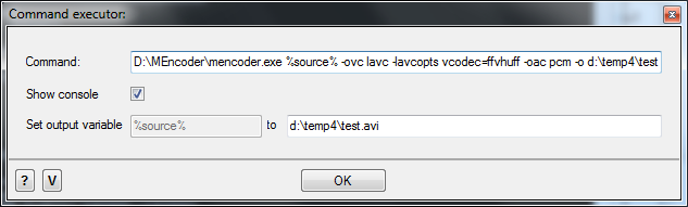

In order to make full use of the "Command executor" decoder you should use the variable %source% as the input file for you command. Ex:
D:\FFAStrans\Processors\MEncoder\mencoder.exe %source% -ovc lavc -lavcopts vcodec=ffvhuff -oac pcm -o d:\temp\test.avi
Note that the output file of your command should be exactly the same in the empty input-box next to "Set output variable %source% to ".
Look at the attached image...
Please let me know if you have problems with this approach.
If you do not set the %source% variable then FFAStrans will continue processing the file delivered by the monitor or manually submitted.
Unfortunately, that does not seem to work in our case.
If we leave the "set output variable" input field empty, the whole workflow is stopped and the original file name argument is not passed to the next encoding step.
The currently prcoessed entry in the monitor window simply disappears and nothing else happens.
If we set the output variable source to a static entry, everything works fine. The custom command is executed, the output file is encoded and stored.
Unfortunately we need to preserve the original filename of the input file in the further encoding and output steps, so a static output name from the command executer is not appropriate in our case.
Do I maybe misunderstand the behavior of the command executer (we need it to preprocess the input file)? Or do I have another brain bug .)

Re: Command executor not executed
I'm afraid you have found a bug/shortcoming in the "Command executor" and the parsing of variables. You are quite right, it's does not work as it should and it will be addressed in the next release. Also, I will see to that there are some more variables available for the user to insert when needed, like the original file name. I have however on the roadmap a comprehensive addition to FFAStrans which will deal with variables in a broad manner. Media properties like TC start, length, width and height and other relevant media properties will be available for the user at any point in the workflow process. This will probably be available in the 0.5.0 release.
