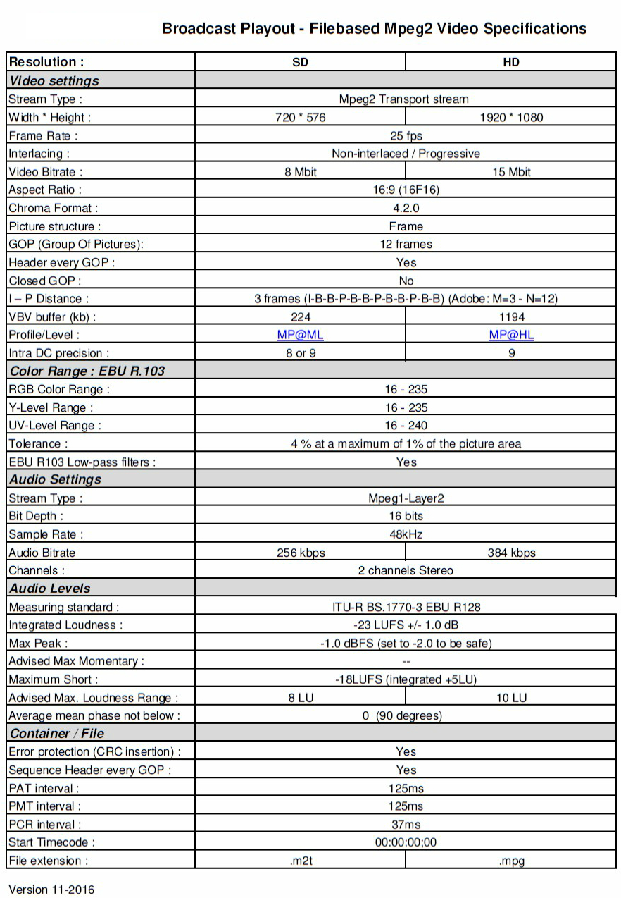

- FFASTRANS should transcode all files found in the watchfolder according to the HD-specifications. (See attached jpg-file)

- Transcode Mpeg-Settings-2016.jpg (724.91 KiB) Viewed 6926 times

Hello Eric,
I think it will be quiet simple but need to use custom ffmpeg encoder. Your specific videofile specification can't be directly out from FFAStrans I think.
Here is an example for your HD videofile :
ffmpeg -i <input file> -c:v mpeg2video -b:v 15M -c:a mp2 -b:a 384k <output file>.mpg
So, create a custom ffmpeg node and paste "-c:v mpeg2video -b:v 15M -c:a mp2 -b:a 384k "
uncheck audio codec,video codec and put .mpg extension.
You can check with mediainfo if all specifications are ok(I don't check all).
I suggest to use conditional before encoding to determinate if your input files are SD or HD. If HD, use that I give you, if SD, change birate (-b:v 15M to 8M and -b:a to 256k).
Hope it will help you.
