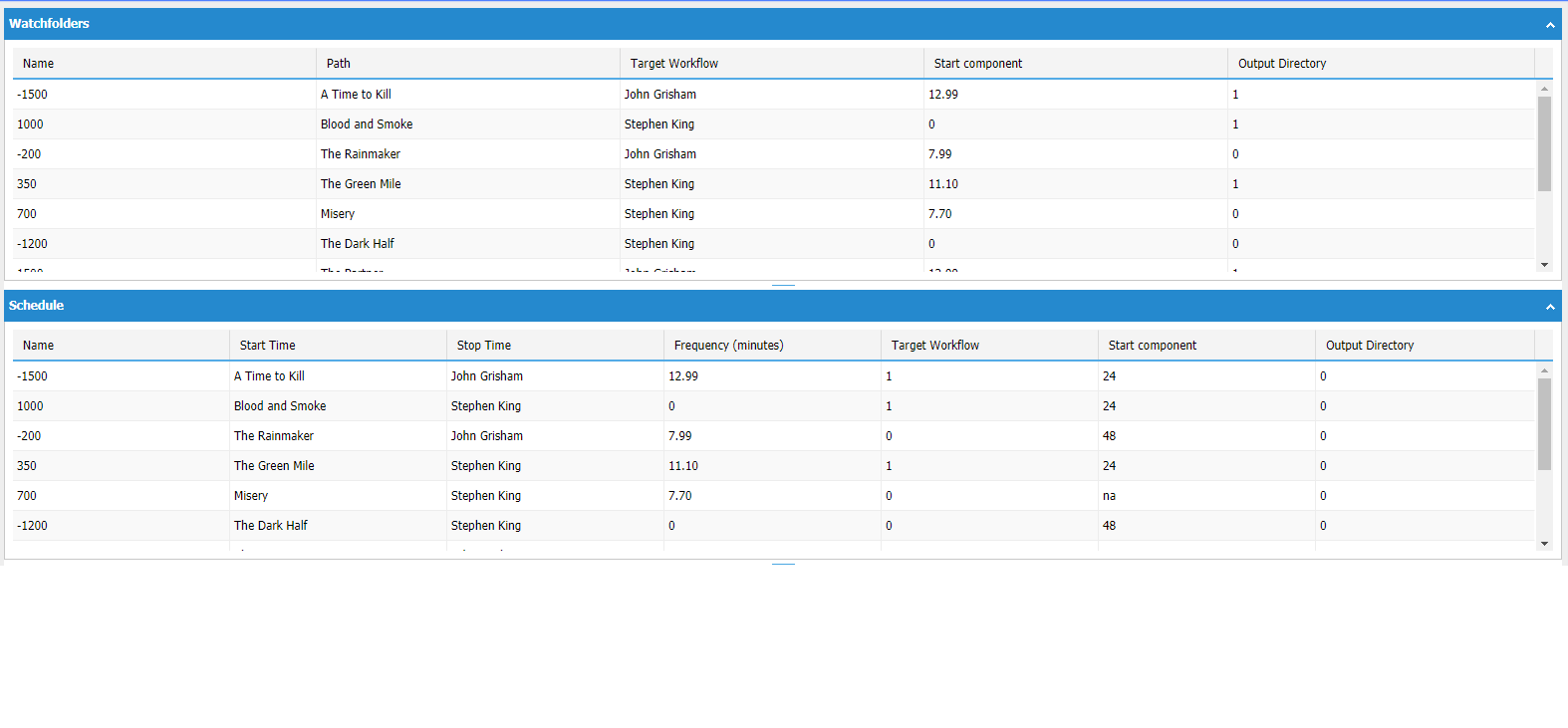

Like this (the values are some random example data, dont get confused by it):

Hey there,
to follow up the original topic about introducting a scheduler:
It would be pretty simple for me to introduce a scheduler on webinterface side. It would run internally every second and check if there are scheduled_jobs that require exectuion.
The problem is that when a job should run e.g. every 1 minute (e.g. a job that compares 2 folders for differences and only carries on processing if there are new differences found), we would also have a job every minute in the history.
So before i continue implementing a scheduler, i would like to ask for ideas how we could handle this case for scheduled jobs that were executed but actually did not do anything. Also one does probably not really like to see a scheduled job that does nothing on the Running job UI. And above that, the actions that are considered as "nothing" should not be queued up but being executed always and immediately.
Any idea if it is possible and simple to come around that topic? Or is this just too far away from the current design?
