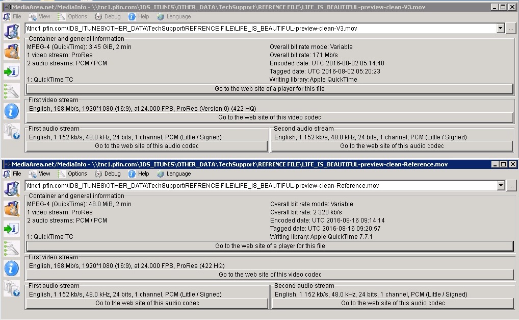

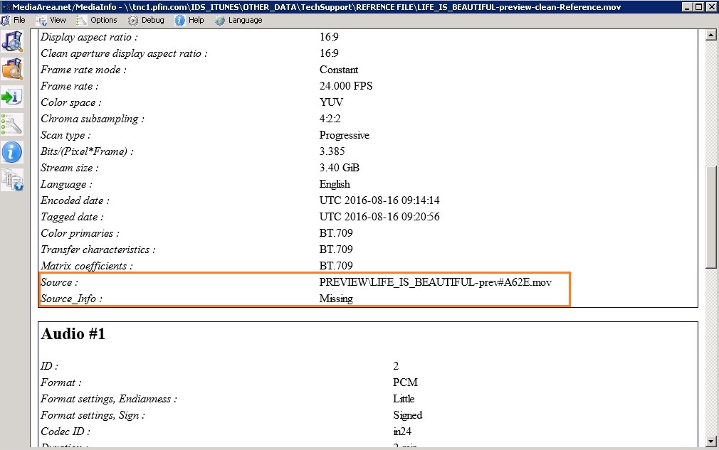

As per my understanding QT reference file is reference file to play source file. I am not sure about QTSource function.
If I used above attached example I am getting output as per my encoding setting. I am not able to to play my original hi-res source file using QTReference file.
I have attached media info of source file and QT reference file which I have created using FCP. If you compare both the media info's you will get all the parameters equivalent to each other. Only difference I have observed is file size and one line added in reference file which is source file location. If I play QTReference file created using FCP I am able to play source file.
Source path.jpg (125.17 KiB) Viewed 89303 times
Please correct me if I am missing anything.
