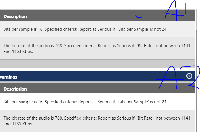

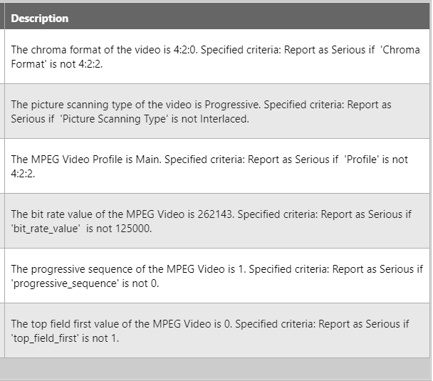

Hi Thanks for the help.
I submitted the video to testing to see if it meets the criteria. but i get some issues that the formatting is not matched.
I attached 2 images with what the criteria is.
A1 - audio track one
A2 - audio track 2
I added before the first map to keep the quality.
even if i am running a command after the output is given, i don't mind.
I know that i can try get few of these done myself like and have checked with the forum but seems like im getting errors.
please any support.
Can i assume this will work
but then stil turns number of audio tracks from 2 to 1 and thats another issue
- Ash
A2 - audio track 2
I added
-qscale 0even if i am running a command after the output is given, i don't mind.
-brplease any support.
ffmpeg -i output.mxf -vcodec mpeg2video -s 1920x1080 -b:v 50000k -maxrate 50000k -bufsize 3835k -minrate 50000k -r 25 -flags ilme -top 1 -acodec pcm_s24le -ar 48000 -pix_fmt yuv422p output2.mxf- Ash
- error1.PNG (26.73 KiB) Viewed 9806 times
- erro2.PNG (24.2 KiB) Viewed 9806 times

Hey, the screenshots from your vidchecker report do not match the ffmpeg command you sent.
However, it looks like you are using Vidchecker with settings for XDCAMHD422, so the settings of your ffmpeg command seem to be ok.
Just make sure to specify encoding settings for each stream taht you have, e.g.
Also, here a copy of the video encoding related settings that ffastrans is using at the "XDCAMHD encoding processor"
The qscale parameter will most likely not have any effect because the bitrate is fixed and extremely high anyway.
-map 1:0 -c:a pcm_s24le -ar 48000 -map 2:0 -c:a pcm_s24le -ar 48000Code: Select all
-vf "copy,colorspace=fast=1:all=bt709:format=yuv422p:ispace=bt709:itrc=bt709:iprimaries=bt709,fps=50,setfield=tff,separatefields,select='not(mod(n\\,4))+not(mod(n+1\\,4))',weave=t,setfield=tff,setdar=dar=16/9,setsar=sar=1" -timecode 00:00:00:00 -c:v mpeg2video -r 25 -pix_fmt yuv422p -aspect 16:9 -intra_vlc 1 -b:v 50000000 -minrate 50000000 -maxrate 50000000 -bufsize 17825792 -rc_init_occupancy 17825792 -bf 2 -non_linear_quant 1 -seq_disp_ext 1 -video_format component -color_range 1 -color_primaries 1 -color_trc 1 -colorspace 1 -chroma_sample_location topleft -signal_standard 4 -dc 8 -qmin 3 -qmax 28 -g 12 -field_order tt -top 1 -flags +ildct+ilme -alternate_scan 1 -intra_matrix 8,10,22,27,29,37,37,40,9,12,14,28,29,37,39,40,9,14,27,31,34,37,40,48,12,22,27,29,34,37,40,58,26,27,29,34,37,38,48,58,26,27,29,36,38,38,48,69,18,27,34,36,38,38,48,69,26,26,34,34,38,40,58,79 -inter_matrix 16,20,22,26,28,32,32,36,18,20,22,28,28,32,34,36,18,22,26,30,30,32,36,38,20,22,26,28,30,32,36,42,24,26,28,30,32,34,38,40,24,26,28,32,34,34,38,42,24,26,30,32,34,34,38,42,24,24,30,30,34,36,40,44 -f mxf -max_muxing_queue_size 125 -metadata "creation_time=now"emcodem, wrapping since 2009 you got the rhyme?

Thanks emcodem,
No errors now with the added code you have given for each media. I will now try the XDCAM on FFAstrans and try it and if it doesnt work, ill try the custom command and see if it works there
