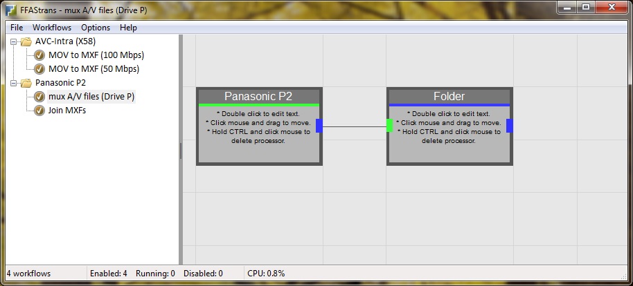

In FFAStrans ver. 0.6.0b, I was able to mux the mxf files from a P2 card. Mediainfo and VLC both show that the clips contain 4 audio streams, however I can't get any sound from any of the muxed clips. I tried playback with VLC as well as Edius. I verified that the p2 clips did in fact record audio.
Here's my workflow:
P2 workflow.jpg (78.23 KiB) Viewed 10073 times
Please advise if there is a better workflow for this. Thanks :geek:

That is weird :?
Can you please download some of the P2 samples from this page http://opencubetech.com/page47/ and let me know if they come out with sound? These are some of my test material and they all come out with sound in my end. Your workflow seems fine.

The test clips play back with audio, so it could have been an issue with my source video. Thanks!

No prob! :-) It's important thou that you let me know if you really DO have audio on your source material and FFAStrans does not properly deal with it.
