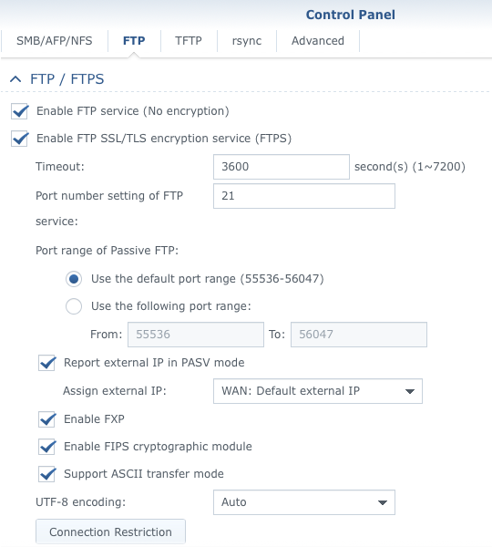

That's my thoughts too. Maybe something related to passive mode, or passive ports, ... Something get stuck in the way the client "talks" to the server and the server "answers" to the client. But I don't really know where I could find the log of the FTP Monitor node "client", so I could see exactly what it's talking about with the server ?
The server is a Synology NAS running DSM's latest version : DSM 6.2.2-24922 Update 4
Here are the settings (I don't know if you're familiar with Synology NAS FTP Server) :
I don't know if it is relevant, but the FFASTRANS P.C. and the Synology NAS FTP Server are on the same local network, so there should not be any routing or Firewall problem : Windows can connect to it, display the folder content, I can move/delete/add/rename files from the Windows File Explorer of the FFASTRANS P.C.
