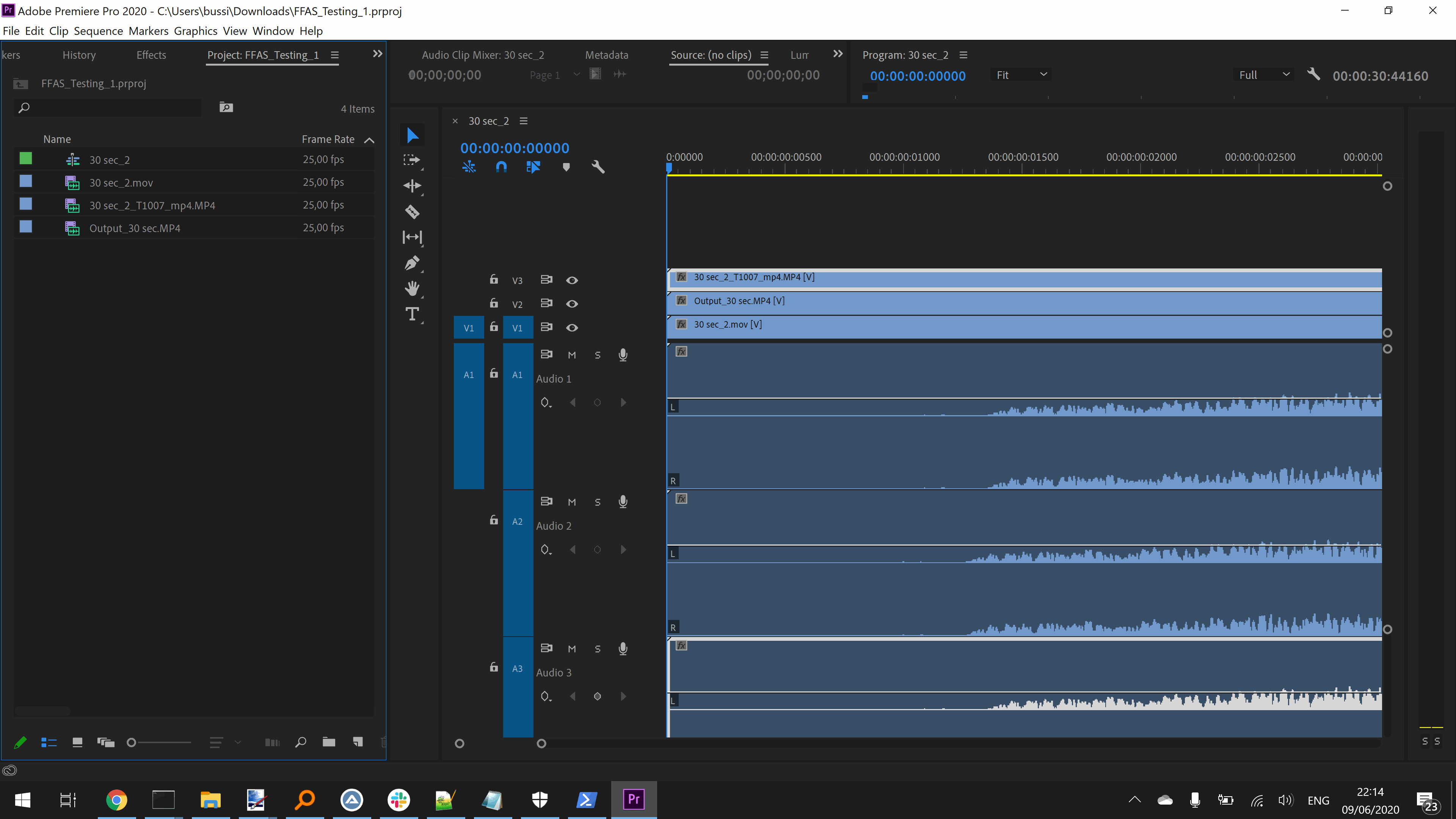

This screenshot is from loading the exact same project file with the exact same input files but it shows different results than on mahmouds try above:
Audio not sync after encode.

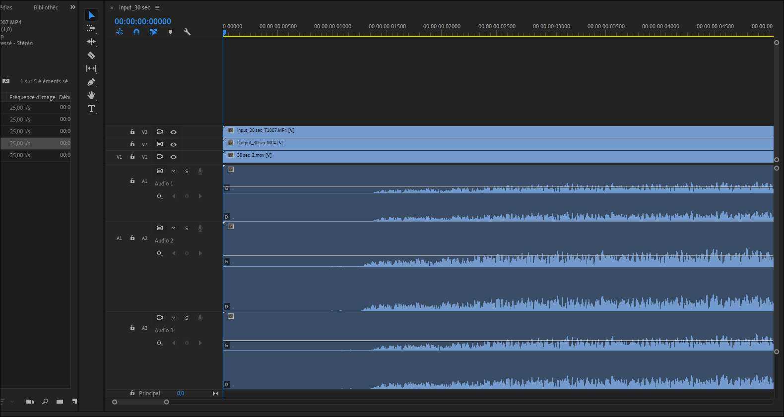

Hi ,
now, my turn
I tried to reproduce your screen : Same files at same places, same timeline scale(00500->01000). I think I have the same result as @encodem.
What are we missing here?
now, my turn

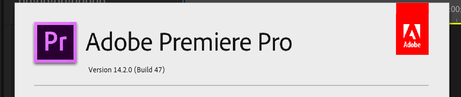

@mahmoud,
we are a little dependent on you here as momocampo and me both open the same sequence but still see different results.
Whats your premiere Version?
