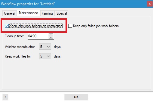

I'm really not able to reproduce with the 1.1.0.2 version. I've tried running through your workflow but it seem to work as expected. I think you must run a job that's failing and send the complete work cache folder for further investigation. The log you sent did not show enough unfortunately.
Can you please make sure this option is enabled and when you have run a job that outputs an .avs file, you need to right click on the monitor and select "Open work folder...". Zip it and send it.
Thanks.
