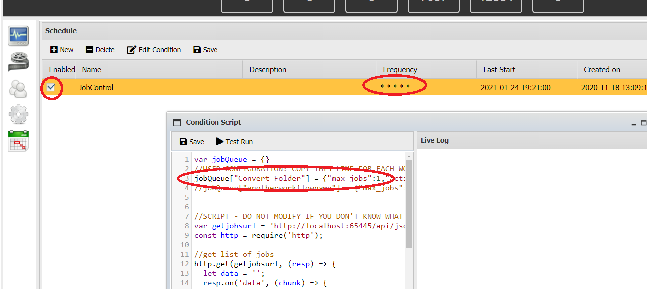

I took a brief look today and I have not been able to run the webinterface with your script for my workflow.
It takes the max of available job like as usual. I thing I miss something as It was the first time I run the webinterface.
What I have already done.
  • Decompress webinterface folder in the same folder as FFAstrans
    running Service.exe.
    Open Webinterface with http://localhost:3002/webinterface/ -> it works I see all my workflow.
    Go to schedule Tab and create a new job.
    Set frequency to minute
    Click edit condition and Copy paste your script without forgetting to replace the name of my workflow. Click save
    Check "enable"
now, What I have to do ?
If a click start on my Workflow in FFAstran it starts and takes the 4 job at the same time.
Sorry I'am newbie :)

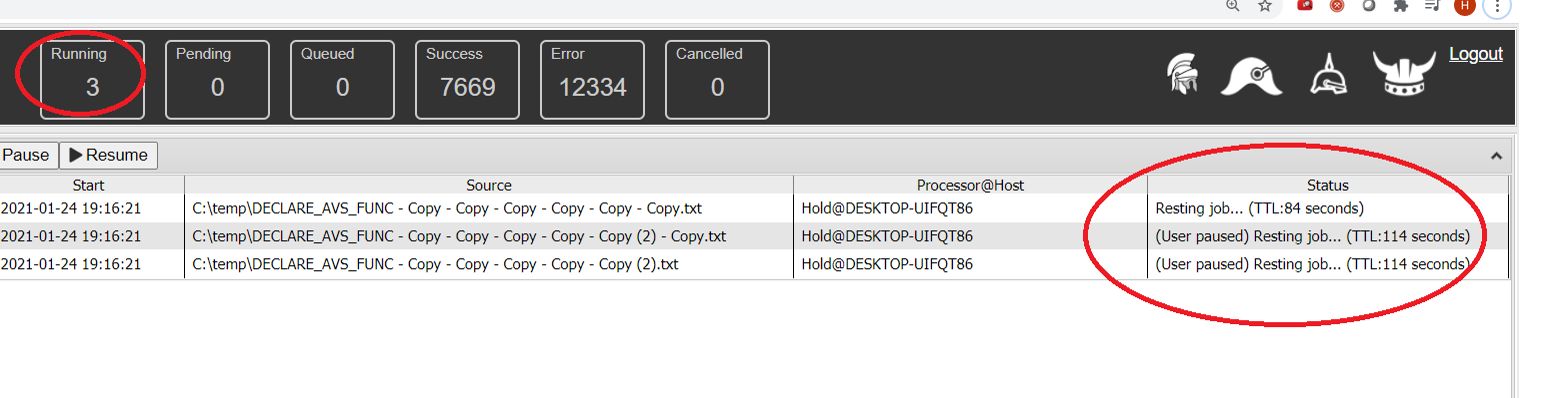

Oh lala @Ghtais, that didnt take a very long time :D thanks for checking out my suggested method.
I just tried (again) and it works for me without a problem. You might probably just have forgotten to "enable" the scheduled job?
As you see, the name of the workflow that i control here is: "Convert Folder".
Also, as you see, the number of running jobs does not decrease (we dont have yet a count for paused jobs, they count as running), but the status line indicates that we have 2 paused and only 1 running job:

the job is enable, and the name of the workflow is correct.
I thing that I have only a little part of the code needed.
I have copy/past the line you gave me before in page 1. When I look at your screen just below you have more than 14 lines.
could you please provide the entire code that I have to run ? Or maybe the rest of the code is useless for our purpose :)
bye
Re: Limit number of jobs per workflow
Oh, thats the problem...
on the first page, i posted a link to an old forum topic with the code that already helped others. Please check again:
viewtopic.php?f=5&t=875&p=5392&hilit=li ... flow#p5387

ok, so with the entire code it works, thank you Emcodem :)
FFAstrans continue to take the maximum of job it could but pause all jobs except one.
During the transcode, It gave me some error flashing on the right up corner of the webinterface but I had not enough time to read it. it still finished the workflow anyway.
