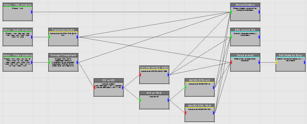

P.S. The workflow is quite simple:
- it moves XML files from source watchfolder to target dropfolder
- it converts all non-PCM /WAV files to PCM/ WAV and drops the result to target dropfolder
- it converts all non-XDCAM compliant files to IMX50/ MXF or XDCAM HD50 / MXF (depending on res) and drops the result to target dropfolder

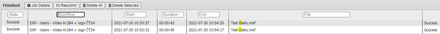

As I have already PMed you the issue occurs when filename of the imported / processed files contains letters with diacritics - for example Czech letter "č" (Windows 1250 codepage 0xE8; Unicode U+010D) or French letter "è".
So let me repeat my question: is there any recommendation from you how to setup Regional setting on machines in FFAStrans Farm? Especially "Language for non-unicode programs" setting?
Filename without czech diacritics - processed once.PNG (9.96 KiB) Viewed 19454 times
Filename with czech diacritics - processed twice.PNG (14.2 KiB) Viewed 19454 times
