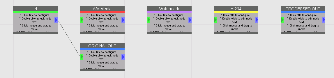

For now, I am trying to find and implement the correct and fastest way to overlay a transparent .png-image (1920x1080px) onto an interlaced video, de-interlace the video and scale down the result. These are the file specs I'm dealing with:
Input: H.264 mp4 video, 1920x1080px, interlaced, 25 frames per second (so 50 fields per second).
Desired output: H.264 mp4 video, 1280x720px, progressive, 50 frames per second, with the .png image overlayed.
Attached is the Workflow in .json and .png format.
I'm not sure about de-interlacing because there is also a separate de-interlacing processor, which I'm not using because the current output is already progressive. Am I doing something wrong? Also, the whole process is already kinda slow which makes me doubt my current approach.
Can somebody help me with this?
Kind regards,
Rene
Looking for correct and fast way to overlay an image onto an interlaced video
- Testing stuff.png (6.77 KiB) Viewed 12066 times
- Testing stuff.json
- (6.96 KiB) Downloaded 869 times

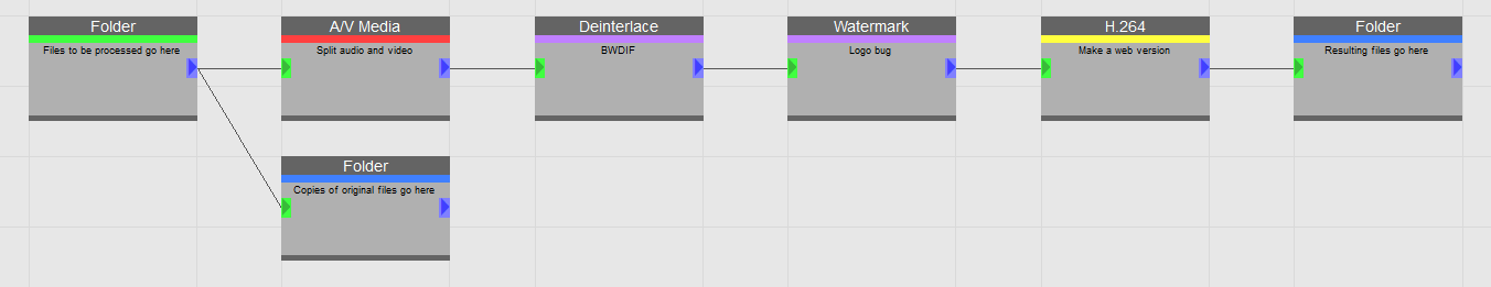

Re: Looking for correct and fast way to overlay an image onto an interlaced video
I haven't checked the workflow yet 'cause I'm using my mobile, but since your image is gonna be overlayed and your final output is gonna be progressive, I would do the following in the following order:
- Watchfolder
- AV Decoder
- Bob Deinterlacer (BWDIF)
- Overlay filter
- H.264 Encoding
- Delivery
Which is pretty much what you're doing already except for the Deinterlacer.
About it, don't worry, it's safe to place it regardless 'cause if your input is progressive, it's not gonna do anything.
This of course if it's flagged as progressive.
If your input is flagged as interlaced and it's actually progressive, a Deinterlacer will Bob but both fields are the same so it will just duplicate frames and you'll end up with 25p duplicated to 50p instead of blended.
Thank you very much for your time Francesco! I now understand that the H.264 processor does not actually do any deinterlacing.
I have now changed the workflow according to your suggestion (with the Deinterlace processor in place) and will work from there.
It is also my understanding that the watermarking proces could be done in FFmpeg through the Command Executer processor to speed up the Workflow, is this correct?
If so, I'll probably be able to figure out what FFmpeg command line parameters to use. But I won't have to go through the trouble if the speed gain would be marginal.
