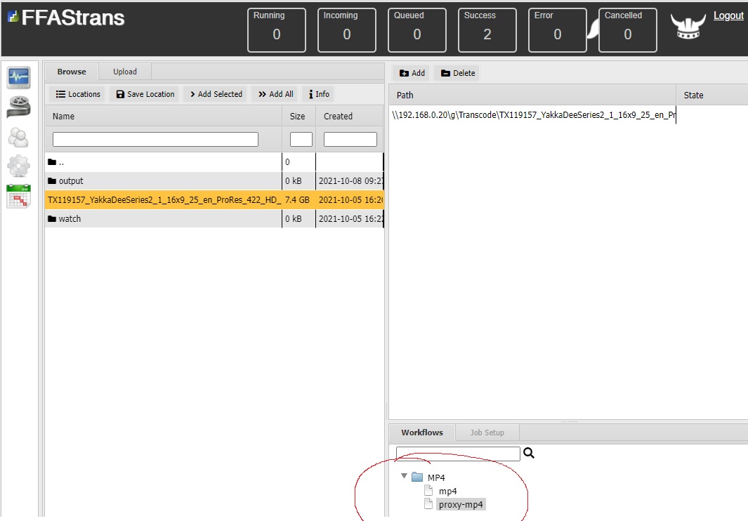

I open the Web Interface http://localhost:3002/webinterface/ and I can see my manually submitted jobs (from the Workflow Manager) They update as the job is transcoding, all is good there.

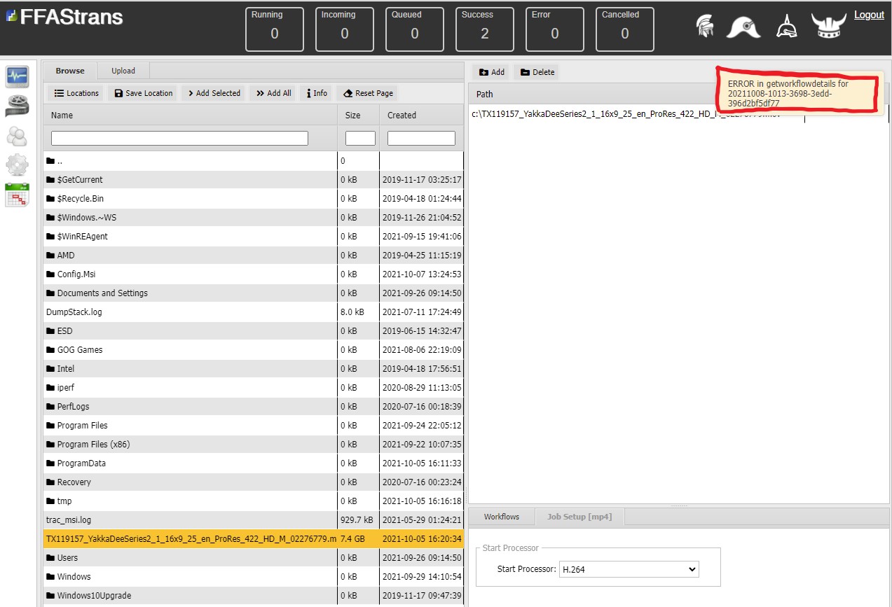

It's when I want to submit a job by the Web Interface, but when I go to select the profile from the Workflows window/tab in the bottom right, the FFAStrans REST-API Service stop abruptly and I get an error in Web Interface (ERROR in getworkflowdetails for ****) Screenshot attached. I can restart the Rest-Api service no problem, but if I go to select a Workflow profile, the same thing happens.

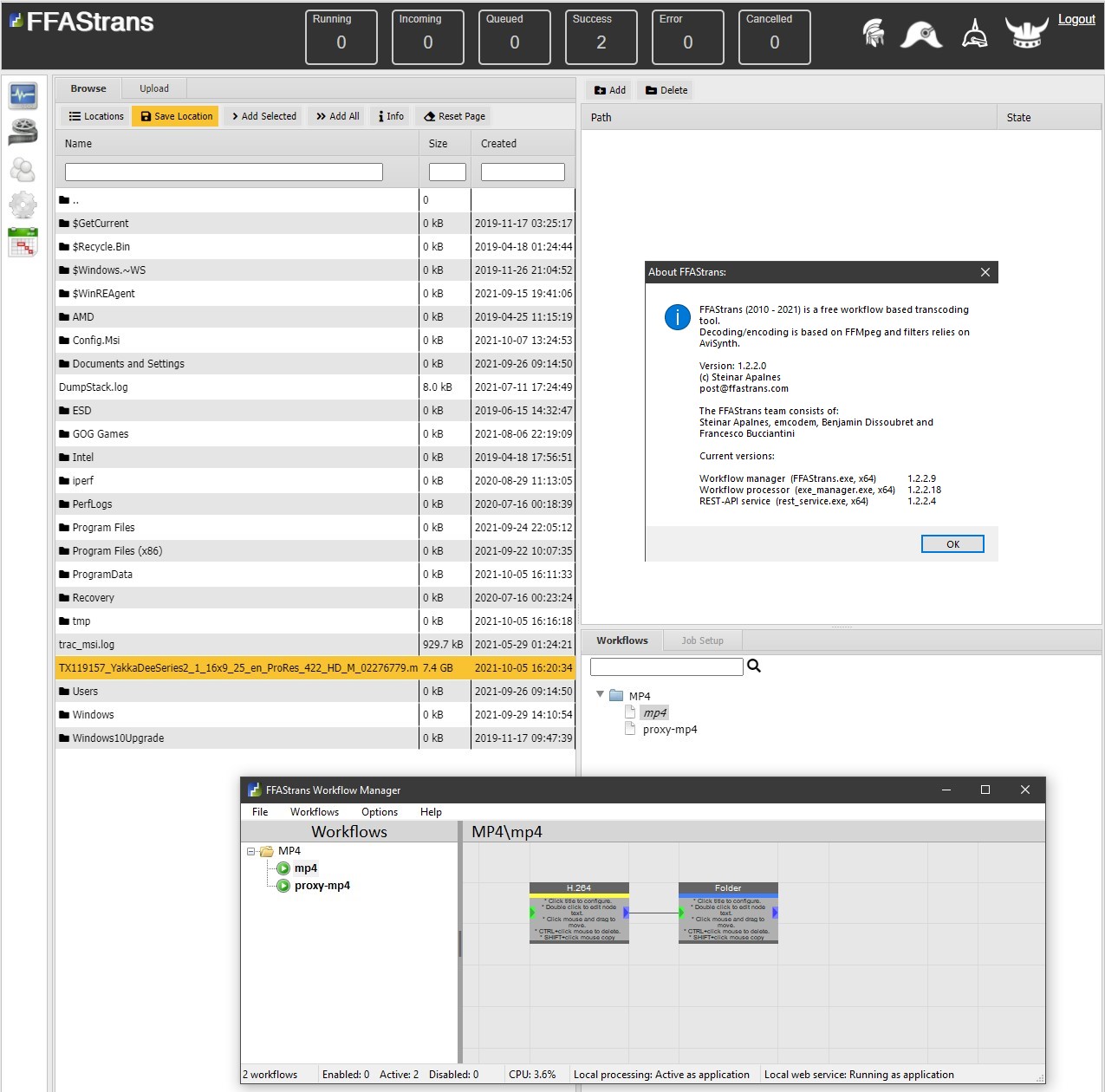

FFASTrans Version:
Version: 1.2.2.0
Workflow manager (FFAStrans.exe, x64) 1.2.2.9
Workflow processor (exe_manager.exe, x64) 1.2.2.18
REST-API service (rest_service.exe, x64) 1.2.2.4

4 - On the Workflows tab, I go to click on either workflow (mp4/proxy-mp4) A little error message pops up: "ERROR in getworkflowdetails for 20211008-1013-3698-3edd-396d2bf5df77".
5 - When the FFASTrans was running as a service, it was at this point the service would cease to run.
But now, I just get the error.

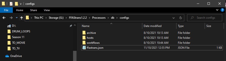

I went to the the location \processors\db\configs and the strangest thing, is that I don't see a user_variables.json file.
I don't know enough to tell if that's normal because I haven't configured any user variables yet? e.g. Audio Loudness/normalisation variables.
I'll leave it as is, I have no worries in reinstalling FFAStrans + web interface. This is just test bench stuff to see how the web interface works, so am happy to do whatever and take notes and share information.

It looks like there is a series of unfortunate events here :D First, the crash seems to be caused by the user_variables.json file not being existent, you can create it by just accessing the variable editor interface (maybe create some user_var), just hit the "<" button in any processor near to most text inputs and select the user_variables tab. After that check if the file exists as described above.
So, this is to fix the crash hopefully.

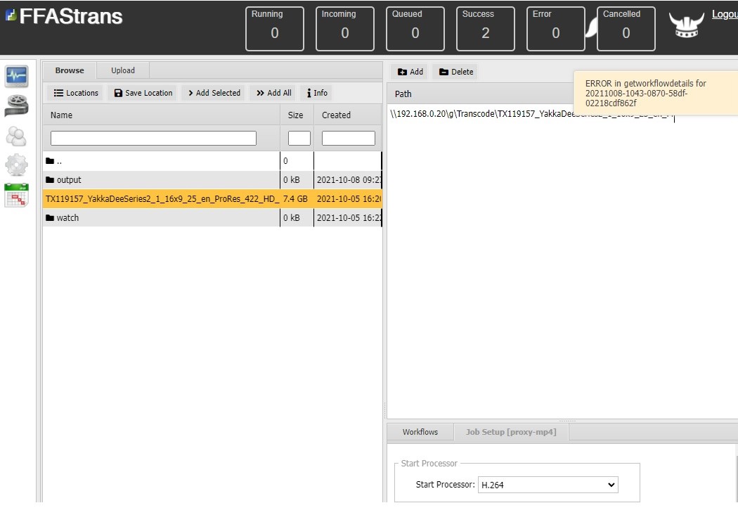

Second, the error message that you see when selecting some workflow comes down to a bug in ffastrans actually. Workflow submission should work as expected tough, you just cannot use the feature to expose variables to the user. Let me know if you need a quick solution for that and i'll send you a patched version of rest_service.exe.

One thing that bugs me tough: you still see the yellow warning on the webinterface when you select a workflow for job submission, right?
