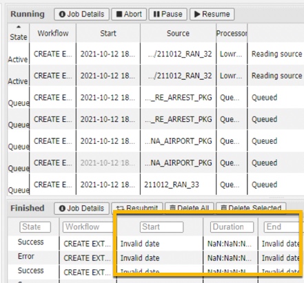

Hi @emcodem,
is there some need to set correct regional settings to get rid of this error in webinterface or is this a bug?
Many thanks,
mrazik
Many thanks,
mrazik

Hey @mrazik
uhm everything should be independent of regional settings.
Does this happen only for certian jobs or all jobs?
Could you post a text file with the output of this please (just call in browser):
http://localhost:65445/api/v2/history

OK i remember that particular piece of code very well... i was thinking: "do i need to make the effort and support timezones with half hours - nahhh how big is the chance that a ffastrans user lives in such a timezone". Looks like i was wrong hehe, i should have looked up timezones so i see that india and australia would be affected at least.
Can you please try this? And please have a look if the time is displayed correctly, i was not 100% sure if i need to put :50 or :30 to my time parsing function "moment".
https://drive.google.com/file/d/1EWrvEq ... sp=sharing

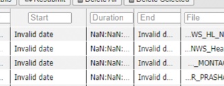

Hi @emcodem,
now the time is shown in running jobs! Unfortunately still missing in processed.
mrazik
mrazik

yeah, the history is already stored in the database of webinterface. New jobs should have a time but the sorting might be defect because invalid times are stored.
I fear to recover completely, you got to stop webinterface, then delete webinterface/database/jobs file and start again. It will re-import all jobs that ffastrans has in history at startup and times should then be correct.
well, no new completed jobs are visible in the processed in webinterface

Even after you deleted the Jobs file?
Yes! Deleting the jobs file makes the magic! Man, I own you a beer!!!
Thank you!
