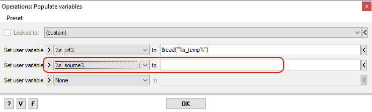

Hi crispyjones,
I think I know the reason for this behavior:
Can you please not set s_source to nothing? Just remove it and see if it helps.

Post by crispyjones »
AHA! This is all starting to make sense. That choice was a result of a discussion with @emcodem about ending a workflow branch without reporting it to the webui. Removing the s_source line does fix it and keeps the job file from being saved, though I do get the extra line reported to the webui. I also tried the other solution of setting a conditional node with "dispel" checked and that also resulted in an unwanted save of the job file.
