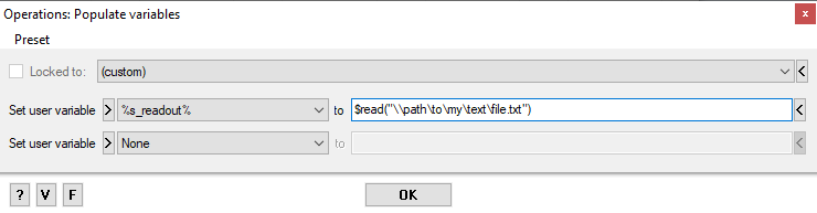

If your text file purely consists of paths separated with a new line then it's quite easy:

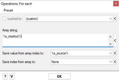

First you must use a "Populate" node to populate a user variable with the readout of your textfile. Then you connect a "Foreach" node to dynamically create branches for each path:
Note that in the "Foreach" node it says "Array string" but it will also accept the kind of text you're supplying with new line separated paths. Try it and report back :-)

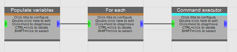

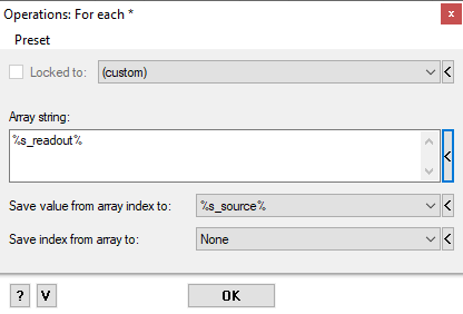

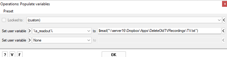

I tried setting up a test workflow:
A populate node, a for-each and a command executor, thats runs a batch file which will do some work.
The populate node should read lines from the text file TV.txt.
The for-each stores the read lines into %s_source% which is then fed into the command executor.
It seems that nothing happens - am I missing someting?

I see you have no monitor for triggering input sources. Do you use manual submit via GUI or the API? The populate node itself does not do anything itself until it's triggered. If you have neither, you can just submit a bogus file to the workflow just for triggering.
