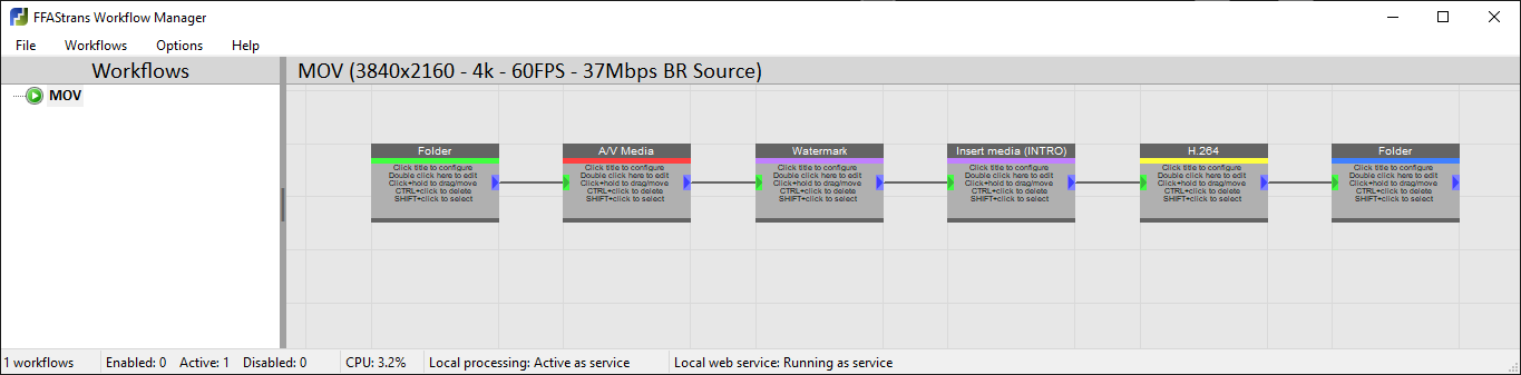

Step 2 is where things aren't going as planned...
^ Unsuccessful 'Insert Media' workflow.
The intro video is .AVI
I have tried:
- Changing the file type of the source file to AVI.
- Converting the source BEFORE the 'Insert Media', then converting it again.
- Bypassing the 'Watermark' to see if that was an issue.
- Tinkering with the H.264 settings (node 5)
No matter what I do, the file enters the status monitor and does its thing, at least up to a point, and then nothing. I get no output video file.
Is this a glitch, or am I doing something fundamentally wrong here?

Re: Adding Intro/Outro with Insert Media filter is not working...
Hi BushBandit, thank you for using FFAStrans and welcome to the forum! :-)
Please make sure you have the same channel count on your intro as the decoded clip in the "A/V Media" step. You have used the default 32 channels. Try setting it to for example 2 and make sure you have two channels (stereo) on your intro.
