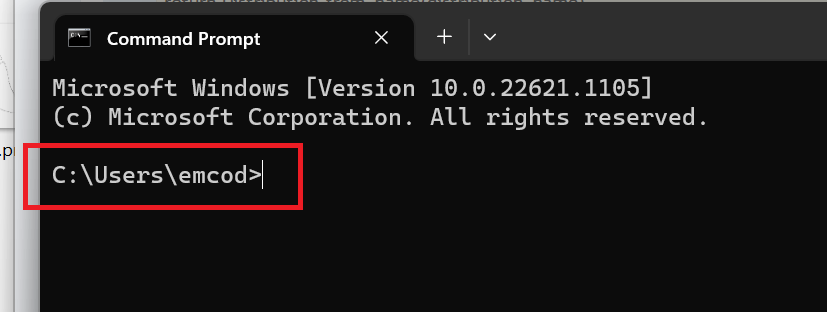

Well obviously it is missing sone py library. That can have py install specific reasons as well as path and cwd.
Best would be if whisper.exe was compiled as a self contained portaple package that has everything it needs inside. I do that usually using py2exe.
Do you run ffastrans as service?
If yes, try stopping the service and see if it works when ffastrans runs as application.
Also, you can try a cd command before executing the exe e.g. Prepend
cd c:\samepath &
In the commdline proc, where samepath is the currend directory you are in when executing it manually on cmd.
Just to be clear, this is the "cwd" (current working directory).
