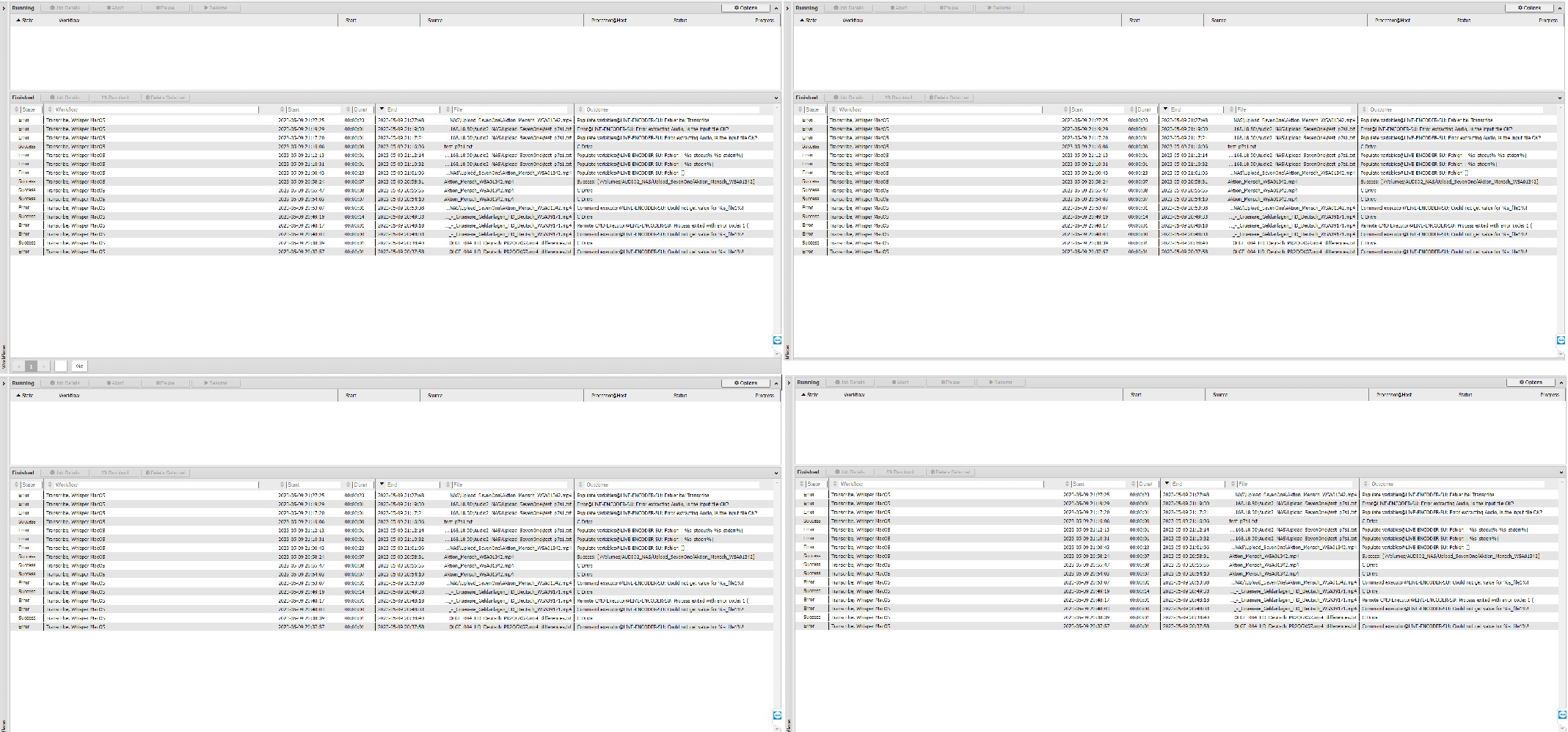

Hey @artjuice
it should be pretty simple for me to send you something that collects jobs from multiple systems instead of one only. But the functionality would be limited to view running and history job list only. Logs will not work, as well as job submit, scheduler and any other function than viewing running and history jobs.
Usually i'd recommend to run one webint per installation and if needed you could easily create a view that shows all status monitors at once, e.g using some chrome Split Screen Layouts plugin or a simple custom html page...
Whats your goal with this - just monitoring?
Simple html page or split screen could look like this:

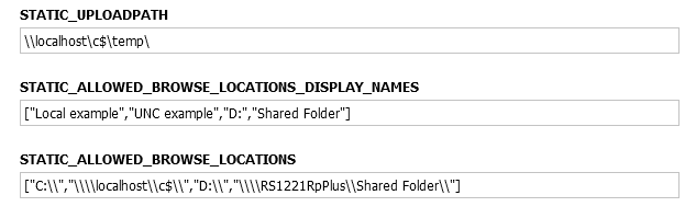

I am very sorry to bother you guys with this, I am sure the answer is probably a very simple one, but I can't see to find it!
I can't add our network drive to the Webinterface locations.
I am trying all sorts of UNC path names, but I always get errors.
The unit is a Synology RS1221RpPlus, the drive name is "Shared Folder".
I tried:
\\\\RS1221RpPlus\Shared Folder\
\\\\RS1221RpPlus\share\Shared Folder\
\\\\RS1221RpPlus\Shared%20Folder\
\\\\RS1221RpPlus\Shared /Folder\
all the above with the IP address instead of RS1221RpPlus
all the above with the mapped letter of the drive on the machine
but no luck!
I am using the software as an application on a single machine. And, I am clearly no expert at all using UNC paths (no need to explain that, I guess!)
Any suggestion would be much appreciated!
Railio wrote: Fri Jun 30, 2023 9:52 am as an application on a single machine.
Ok so for UNC experiments, we usually just use windows explorer for testing.
if you can open this EXACT PATH
\\RS1221RpPlus\Shared\Folder\
In windows explorer and it does not ask you popup for username and password then you can go on
Correct path for webint is simple: every backslash becomes 2, e. G. As seen in your screenshot
\\\\RS1221RpPlus\\Shared\\Folder\\
Now, if you really run as application e. G. You start sever.exe by doubleclick and not as service it must work.
If you run as service, you need to open services and configure username and password for ffastrans webint service.
Btw, in the next webint version this gets a lot easier, no more double backslash and comma seprated stuff :D
