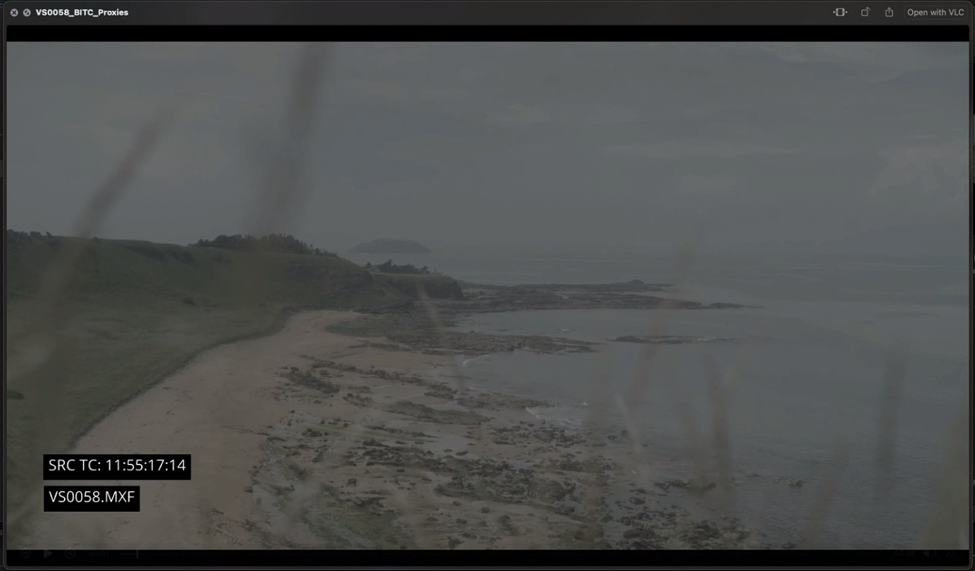

I'd kindly like to request a few features to be added to the BITC Timecode feature if possible.
I'd like to make the BITC even smaller than what is currently possible.
Also, it would be great if you could burn in the clip name alongside the timecode - like in the attached screengrab.
I've used Resolve to make the attached proxy with BITC and filename burned in.
Ideally, the file name will be left aligned so that longer names don't start pushing the text off-screen to the left.

- Screenshot 2024-07-19 122922.png (992.33 KiB) Viewed 57278 times

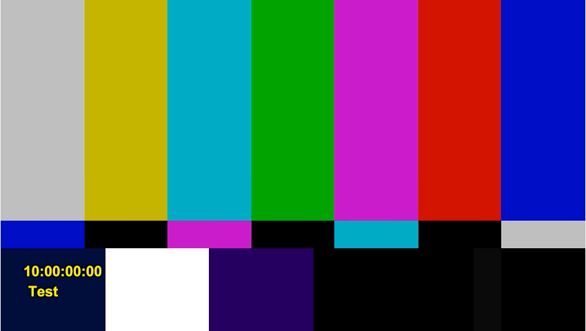

For instance, I've used the following hardcoded values in AVSPmod mod (an IDE for Avisynth) to emulate what you showed in the screenshot:
p.s FranceBB stands for Francesco Bucciantini which is my name and surname. In English the natural translation of Francesco would be Frank, so feel free to call me Frank.
For instance, you could do something like this:
ShowSMPTE(m_clip, fps=%f_frame_rate%, offset="%s_start_tc%")
Subtitle("%s_original_name%")
m_clip=last
return m_clipFor instance, I've used the following hardcoded values in AVSPmod mod (an IDE for Avisynth) to emulate what you showed in the screenshot:
ColorBars(848, 480, pixel_type="YV12")
ShowSMPTE(fps=25, offset="10:00:00:00", size=24, x=90, y=400)
Subtitle("Test", size=24, x=40, y=410)p.s FranceBB stands for Francesco Bucciantini which is my name and surname. In English the natural translation of Francesco would be Frank, so feel free to call me Frank.
