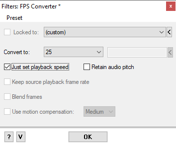

Emcodem is correct that there is no customizable global setting for frame rate. But FFAStrans has it's own internal parameter set to static 25 that's used when we have none. In your case you can use either what emcodem suggest or simply use the inbuilt "FPS Converter" filter:
And we can certainly discuss the option for overriding the global parameter for frame rate in a future release.

admin wrote: Sun Sep 22, 2024 10:54 am simply use the inbuilt "FPS Converter" filter:
Re: Audio to video conversion issue
Baev12, did you try with the setting displayed in the screen shot I posted?

admin wrote: Sun Sep 22, 2024 6:09 pm did you try with the setting displayed in the screen shot I posted?
I think no, sorry.. Because i tryed yesterday again with your setings and it worked fine for the same workflow too. Thank you!
I see that avs script with this settings does almost the same:
m_clip = AssumeFPS(m_clip, 25, sync_audio = true).ResampleAudio(48000)
Return m_clip
