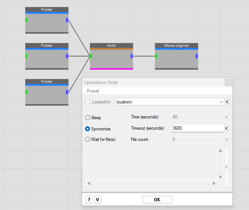

Hi Conrado,
You can use a hold node to synchronize all your branches. This will allow you to move your original file without any issue at the end of your workflow.
So put a hold node like this :
hope it helps.
hope it helps.
- hold.png (50.44 KiB) Viewed 82913 times
