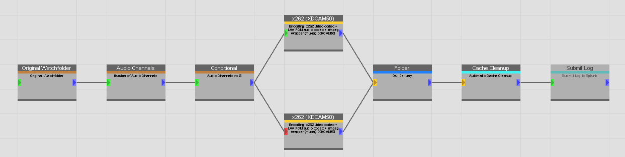

First, create a Populate Variable node and create the variable %s_my_recursed_path%.
Set my_recursed_path equal to the path to the watchfolder you would normally have, in my case the input path of the watchfolder is
M:\Media Ingest\Avisynth_Server1\Node1\x262_in
which means that in the populate variable I have
%s_my_recursed_path% == $replace("%s_original_folder%", "\Media Ingest\Avisynth_Server1\Node1\x262_in", "")
When you then create a delivery node, put the path you want the files to be delivered to there and append the new recursed path variable.
In my case:
M:\Media Ingest\OUTPUT Avisynth Server 1\Node1\%s_my_recursed_path%
In attachment you're gonna find a workflow with the example you're looking for.
x262_sp1.json
(16.48 KiB) Downloaded 1489 times
To make it work with your use case, the populate variable would be:
%s_my_recursed_path% == $replace("%s_original_folder%", "\01_Online", "")
and then the delivery node would be:
Y:\01_Offline\%s_my_recursed_path%
