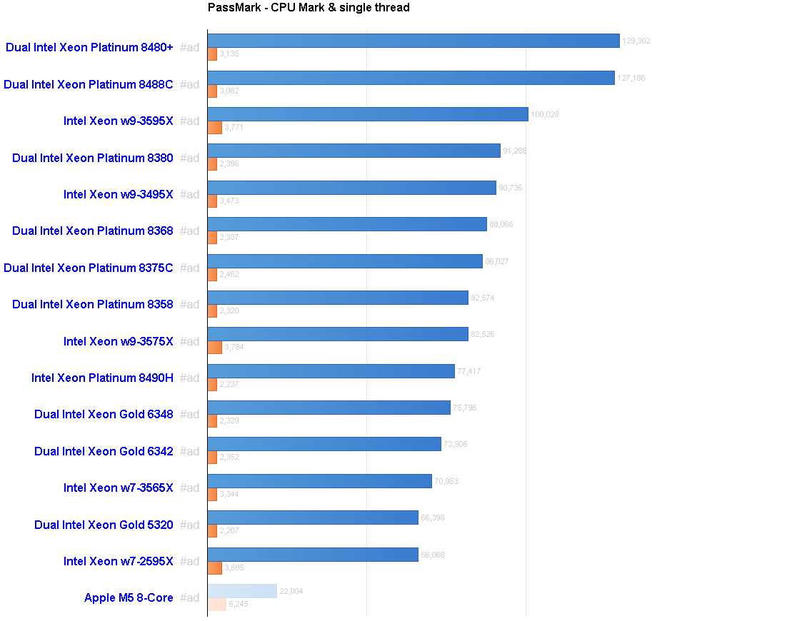

Jokes aside, although M1, M2 etc are probably some of the best ARM chips out there compared to what Qualcomm, Samsung and Google produce, they're still years away from proper Intel Xeon server CPUs. This is because ARM CPUs are - by design - created to work as efficiently as possible on mobile devices while drawing the least amount of power possible. In ARM you have specialized components meant to execute particular tasks, however encoding and in particular filtering isn't something that can be offloaded to one of the various modules, so it has to be performed directly on the CPU as normal operations, which is where ARM falls short. The reason why you can encode things efficiently on MacOS is that they're using hardware encoding, so you're not really using the CPU to make the calculations. Using Avisynth + x264, x265 etc is another story, though. Although they have manually written intrinsics in assembly for ARM as well (i.e NEON), they're nothing compared to a proper server CPU with SSE, SSE2, SSSE3, SSE4.1, SSE4.2, AVX, AVX2, AVX512 and AMX.
aollaku wrote: Sat Mar 21, 2026 5:06 pm Apple Silicon performance is way better than Intel's chips these days.
I felt bad making an Apple M5 ARM 8c compete against an Intel Xeon 698X 86c/172th with AVX512, so I've included a few more Xeons from several years ago in the benchmark and - to give it a slight chance - I even limited it to single core single thread. Still, that poor ARM CPU fell short against x86_64.
