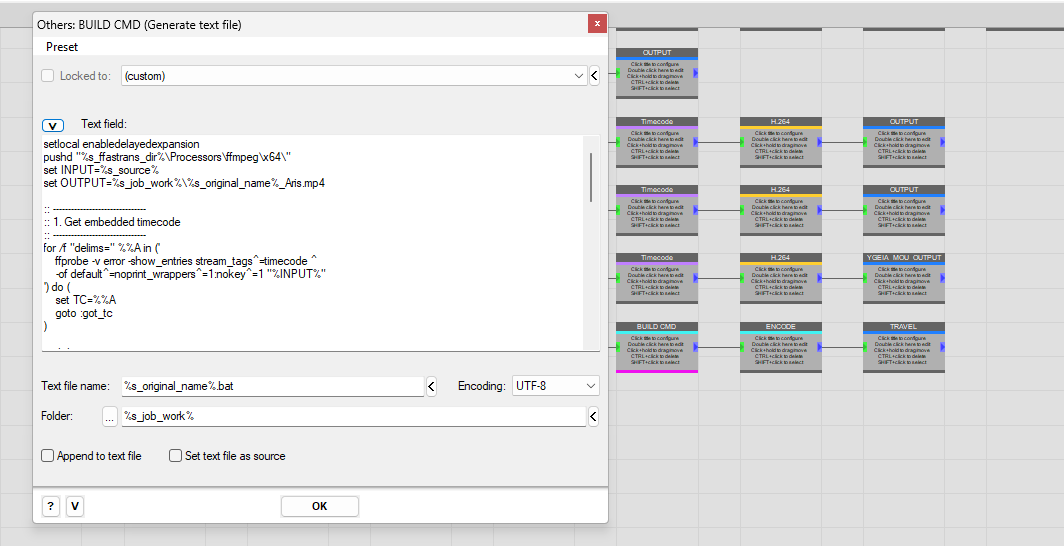

So I moved on to generating a text file and using the command executor.
It worked, but it wasn’t easy to edit due to the FFAStrans UI and AutoIt controls.
At that point, I thought I might as well start developing my own plugin.

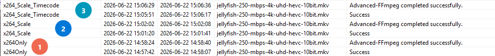

What I described was the whole workflow not just decoding.
For the moment I only need resize (downscale) and timecode burn in.
https://repo.jellyfin.org/archive/jelly ... 0bit%2Emkv
Used this file for testing:
jellyfish-250-mbps-4k-uhd-hevc-10bit.mkv
Tests run on conversion
I performed 3 tests.
1)Convert to x264.
2)Convert to x264 and resize to 720p.
3)Convert to x264, resize to 720p and burn timecode.
This is with no hardware acceleration.
no hwaccel
no hwaccel
System used:
Intel Core i9 14900KF and RTX 5060 Ti
That's all.
