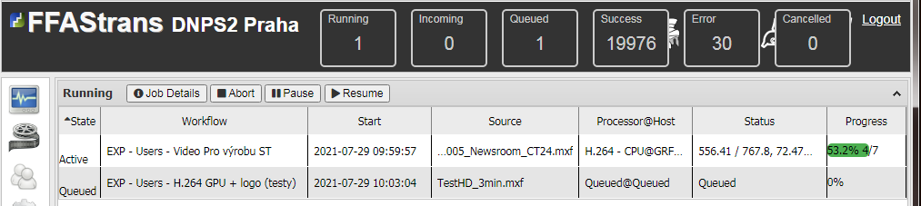

@emcodem
I have installed new version and it seems I have found a bug:
- I have started a job manually (Sumbmit files to "processor node")
- the workflow involved is limited to just one transcode node named "pr-carb-srv-2"
- job has appeared in Webinterface but it is stucked in Queued state (see screenshot)
- job is not visible in Status monitor (see screenshot)
What logs should I collect and send to you?
- Manually started job - not visible in Status monitor.PNG (13.26 KiB) Viewed 15260 times
- Manually started job - stucked in Queued state in Webinterface.PNG (38.27 KiB) Viewed 15265 times

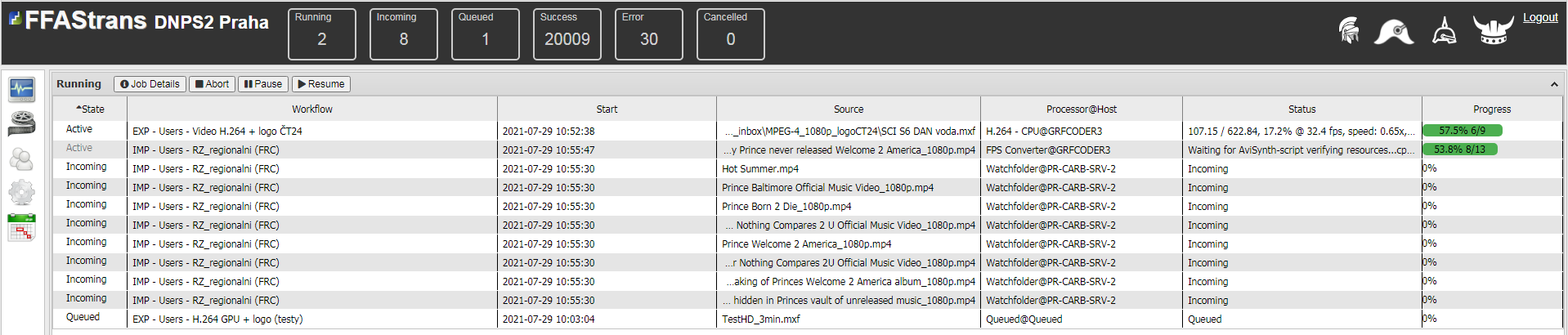

Re: FFAStrans workflows not balancing between hosts in transcoding farm
@emcodem
I had to rollback to official version of exe_manager, because job distribution was not working as expected
. What happened:
- there were two jobs running on node "GRFCODER3" (node capacity limited to two simult. jobs)
- Webinterface has shown a bunch of new files in Incoming status (see screenshot)
- they have disappeared from the list shortly, but have not been assigned to other (free) transcode nodes
- New jobs in 'incoming' - but not assigned to transcode nodes.PNG (99.25 KiB) Viewed 15263 times
