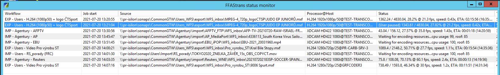

Unfortunatelly I have confirm, that sometimes jobs are assigned to the transcoding nodes in the way, that some nodes are overloaded while other are doing just one job or none. See screenshot attached:
- I have got 4 transcoding nodes in the farme with hostnames "GRFCODER3" (Win10), "PR-CARB-SRV-2" (still WS2008), "PR-CARB-SRV-3" (WS2012) and "TEST-TRANSCODER" (WS2012)
- from the screenshot you can see, that "TEST-TRANSCODER" is overloaded by 7 jobs and 3 of them are in "Waiting for resources state", while others have got just one job or even none ("PR-CARB-SRV-2")
Is there any chance how to improve jobs distrubution (beside using the "List of exlude / include hosts" for static assignment of individual workflows)?

FFAStrans status monitor - one transcode node overloaded while others not utilized.PNG
FFAStrans status monitor - one transcode node overloaded while others not utilized.PNG (59.21 KiB) Viewed 16257 times
