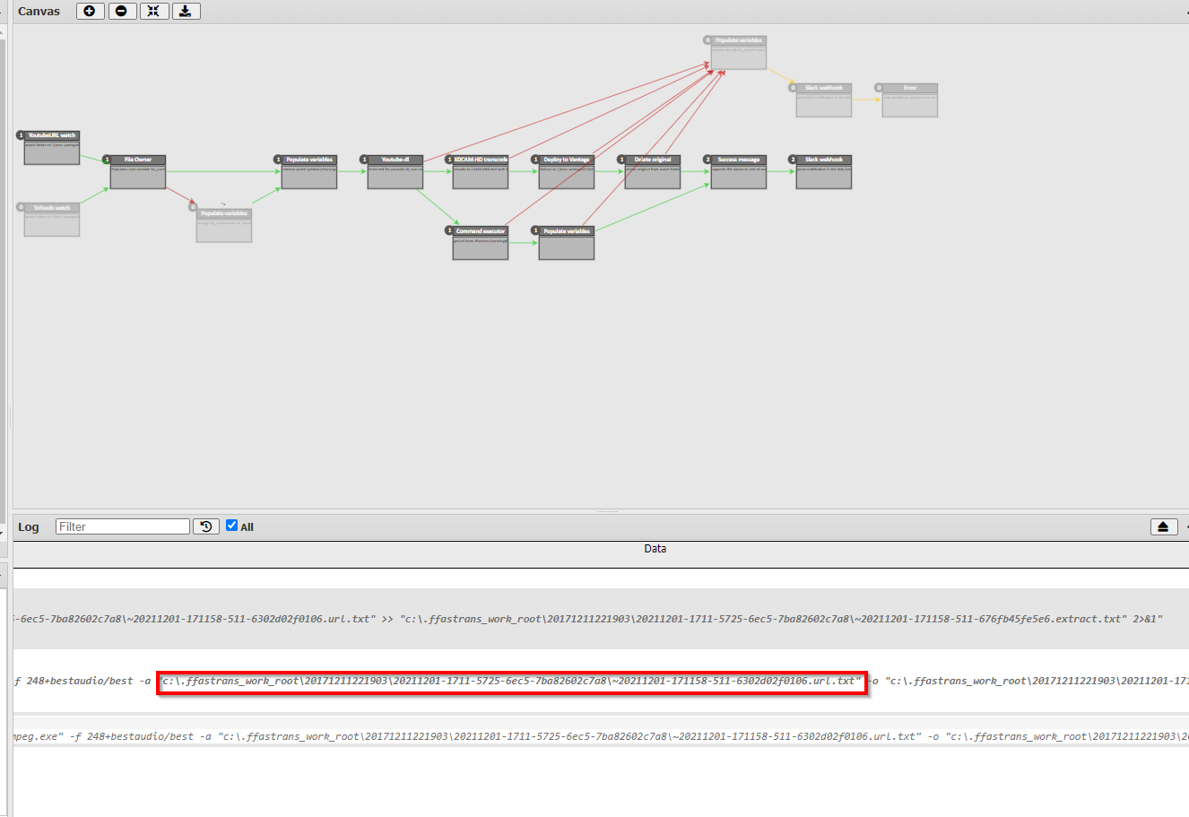

I haven't had any issues running this on my production server. One more positive thing of note, yt-dlp released a new version yesterday and I checked today and FFAStrans automatically updated from version 2021.11.10.1 to the 2021.12.01 without issue. The new version continues to run fine.
One thing that would be helpful, if a new youtube-dl node is in the works, is to expose the actual URL to emcodem's webUI. Currently you can only see the name of the shortcut dropped into the folder in the job info view, not the actual URL that youtube-dl is downloading (because it's in a text file). I've created a workflow branch that uses a com executor to search the workflow working dir for the url.txt file and read its contents to a variable, but it's a bit kludgey.
2021-12-01 18_42_08-Window.png (55.35 KiB) Viewed 20395 times
