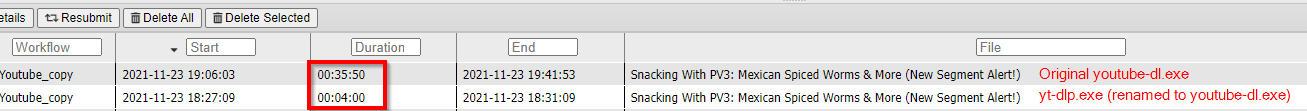

As a test I simply renamed the yt-dlp executable to youtube-dl.exe and replaced the one in the /processors/ffmpeg directory and it worked. At least my simple youtube download>transcode>deliver workflow functioned without issue. The speed increase was great, back to the way it used to be. A 9 minute youtube video took 35 minutes with the original youtube-dl.exe and only 4 minutes using yt-dlp.exe.
2021-11-23 19_44_54-localhost_3002_webinterface_2.png (17.61 KiB) Viewed 22982 times
