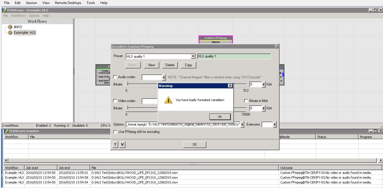

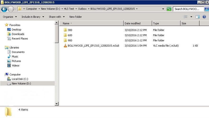

Thanks for your help. I am able to create HLS package as per requirement. But I am observing one issue while processing jobs, I am getting all the files in output location but in monitor window I am getting error message No video or audio found in media. Please find attached screen shot for your reference.
I also wanted to auto create folder as per bitrate at output folder with source file name and wanted to create .ts files in that folder. Can you please suggest. As per attached screen shot.
While changing any settings in custom FFMPEG option I am getting attached message.

The job will "fail" because the custom ffmpeg command does not deliver what FFAStrans expects it to. FFAStrans does not know that it should check all the .ts-filer and it never will. But I will take a look at how to avoid this error message, because your workflow obviously dose not fail.
You can add a "Command executor" node, prior to the encoding steps, with the following command:
%ComSpec% /c "md "C:\Test\CA Test\HLS\Outbox\300" "C:\Test\CA Test\HLS\Outbox\600" "C:\Test\CA Test\HLS\Outbox\900""
This will generate all the folders for your custom ffmpeg preset. You must of course remember to change all other paths accordingly.
The "You have badly formated variables" was a good idea at a time but it isn't
It's gone in the next release. You can allways edit the inputfield but you must move around using the arrow keys.
