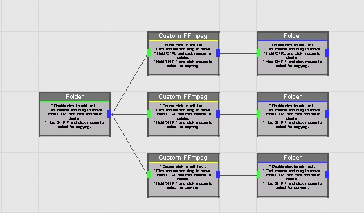

I have created three adaptive bitrates using three different workflows as per below. I am getting three m3u8 files along with .ts files in three particular folder.
Now I am facing one more issue, as per the HLS package requirement I need to create main m3u8 file which can play three adaptive bitrate as per the net speed. Do you suggest on this.

Ok, now I think see where you're trying to accomplish. HLS is not something I'm very familiar with but googling around it seems you want to create a m3u8 text file that looks something like this example? (Might that be a correct assumption?)
#EXTM3U
#EXT-X-STREAM-INF:PROGRAM-ID=1,BANDWIDTH=921600,RESOLUTION=1280x720
900.m3u8
#EXT-X-STREAM-INF:PROGRAM-ID=1,BANDWIDTH=614400,RESOLUTION=640x360
600.m3u8
#EXT-X-STREAM-INF:PROGRAM-ID=1,BANDWIDTH=307200,RESOLUTION=320x240
300.m3u8
