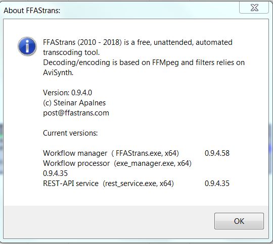

- Cattura.JPG (46.6 KiB) Viewed 12269 times

I'm sorry but I have been very busy. But your most urgent problem is obviously FFAStrans not picking up files. So you have created a simple workflow with a generic folder monitor. And you can see in the status monitor that no files are being picked up. I see from the screenshot that you are running as service. Can you please stop the service and run as application instead and see if it helps? Also, are you able to submit files manually?
