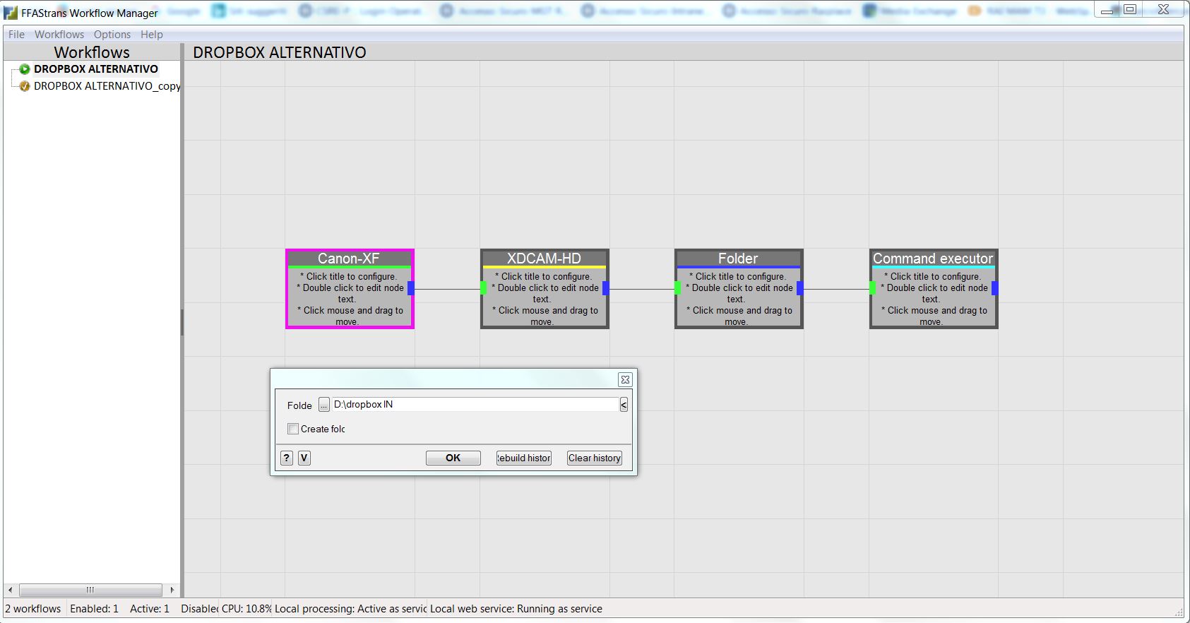

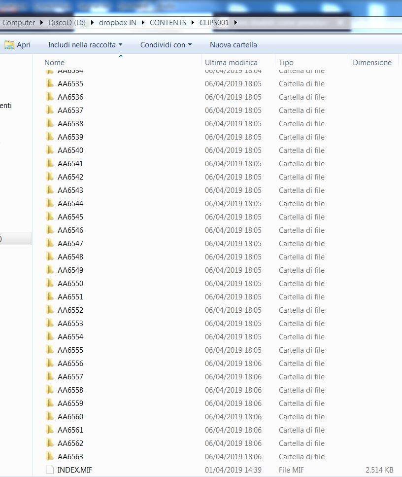

create a single mxf file from the canon xf card xdcam
Post by carmos1975 »
hello Steinar,
I can't chain the canonXF 105 CF card into a single file, containing mxf 50mbit 1920x1080 files and 2 audio tracks.
I copied the CONTENTS of the card to the folder where the CANONXF folder points, but no process starts.
what am I doing wrong?
Could you give me some help?
I'm attaching 2 screenshots to you.
the first s the workflow that should trigger the process.
the second is how the root of the CF card of CANON XF 105 is structured.

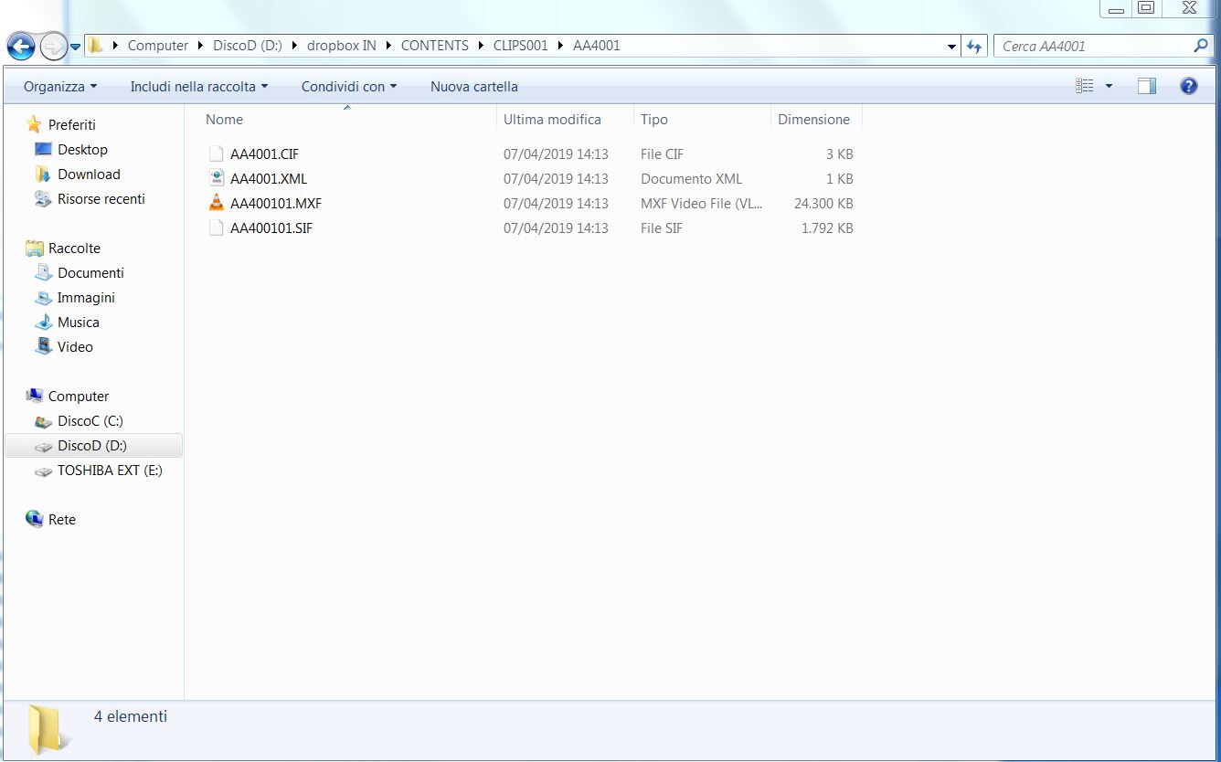

Can you please supply a screenshot that shows the contents of one of your AA-folders? I just need to see structure inside to see if it differs from what FFAStrans expect to find.
Regaring chaining to one file; FFAStrans does not chain all XF-files, just the one that have spanned clips.

here is the screenshot of the contents of the AA folder.
I tried also with a P2 card (obviously modifying the workflow) but even in this case the conversion process does not start.
I don't understand what I'm wrong
Re: Combining Xdcam . MXF files into One
Which version of FFAStrans are you running? Please check the versions under Help -> About. Also, can you please create a simple workflow where you use just a regular folder monitor and see if it picks up files?
