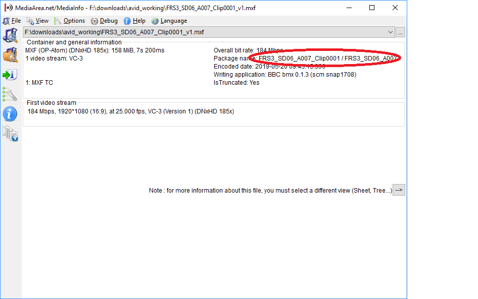

@Vininski: i struggle a little with your screenshot not showing whats wrong with the clips you already uploaded... typically when dealing with such problems, i concentrate on using always the same "works" and "don't work" samples.
However, from your video, i see that your problem is that the clip FRS3_SD07_A008_Clip0102 seems to reference FRS3_SD07_A008_Clip0101.
Can you confirm that mediainfo shows the correct package name for clip FRS3_SD07_A008_Clip0102?

EDIT: Forgot to add that yes all these clips and the previous example showed the correct "Package name" in mediainfo. Still have no idea why they are not being referenced correctly.

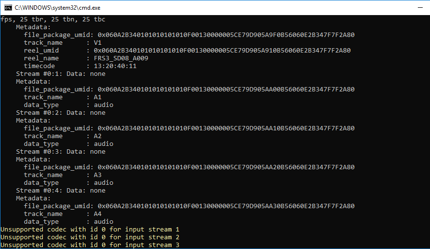

Re: DNxHD encoding issues
Posted: Tue Jul 02, 2019 7:02 am
Hey Vinny,
sorry for the delay.
OK, i found out some very disturbing thing about your 3 files, (perfect examples and screenrecordings, thanks!): they all have the same "file_package_umid", here how the umid looks like, you can use ffprobe to see it.
Now as i understand, AVID relies on those umids so it might be the cause of your issue. I did some testing how you can influence the UMID and it looks like it is generated automatically out of the project name and or tape name you enter in the dnhxh encoding node. It does not seem to consider the "clip name" which indicates that the guys from BBC that developed bmxtranswrap assumed that there will be only one mxf file per tape and it will contain all clips of the tape. (I am not even sure if this is possible in an ATOM file)
So i guess you can solve your issue by making sure to have a unique tape name (add %s_original_name% to the tape name or so).
In case this turns out to work and you desperately need the tape name to be exactly the same for all files, you'd need to open a feature request in the forum and ask steinar to utilize the --mp-uid option with bmxtranswrap to create a unique MP for every file that was created. I am not sure if having a MP UID that is not created out of tape and reel name does conform to the standard but we would probably handle that topic in the corresponding thread then.
Could you please test this?
