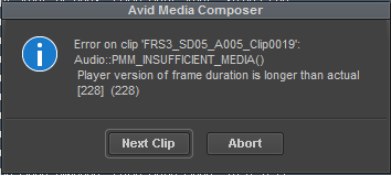

Just found a clip with that frame issue, it popped up when I tried to read the audio timecode on all the clips in the bin. Here's the exact error message:
Error on clip "FRS3_SD05_A005_Clip0019":
Audio::PMM_INSUFFICIENT_MEDIA()
Player version of frame duration is longer than actual
[228] (228)
Clip0019 - Spits above error in Avid on first pass, It also occurs when trying to play the clip in the source monitor. Works fine on second pass. Timecode on both transcodes are different. First pass 10:30:24:09, second 10:30:33:12. Logs attached.
[228] (228)
