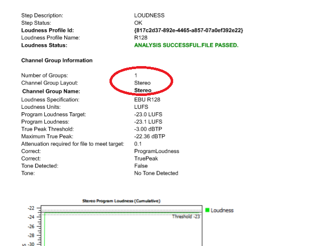

Just to be sure i threw the corrected mxf output to an Eff installation here, the result should look like this for you:

so just as steinar said, you are checking for mono track configuration. In your Report, you see that the loudness check is done using mono configuration:
Channel Group Layout: Mono_Mono
So you need to decide if you set ffastrans loudness node to do mono channel analyzing OR you need to set your Eff to Stereo config.
What is the actual content of your files when you listen to it, is it stereo or mono?

So what you want is to check a stereo configuration, is that correct?
In the end all you need to do is to play with Eff settings up to the point where it writes in the test result (as in my screenshot):
Channel Group Layout:Stereo
Sorry but i cannot help you with settings for this software, but it should be easy for you to get support from the vendor to help you set things correctly.
