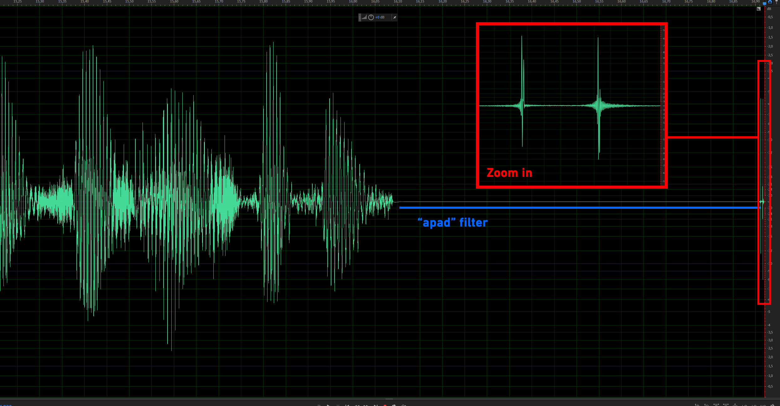

I try to remove the last "x" seconds or milliseconds of the audio in the last (make MP3) Node. I think the VST Plugins StereoTool generates theese Cklick Sounds when audio stops. (See Pic)
- I tried the filter "afade" with
afade=t=out:st=%f_duration%:d=1
- apad with negativ values doesnt work.
- and many many more (about 120 Variations :| )
I´m able to cut X Seconds at the beginning but not X Seconds at the end of the file
This is the Original Code withot any fade or cut commands. What Command is able to use and where to place it?
"%s_ffmpeg%" -i "%s_job_work%\%s_original_name%_WATSON.wav" -filter:a volume=-0.5dB -b:a 320k -codec:a libmp3lame -y "C:\Users\USERNAME\Desktop\VST Host Test\OUT\%s_original_name%_EDIT_%i_hour%_%i_min%_%i_sec%.mp3"

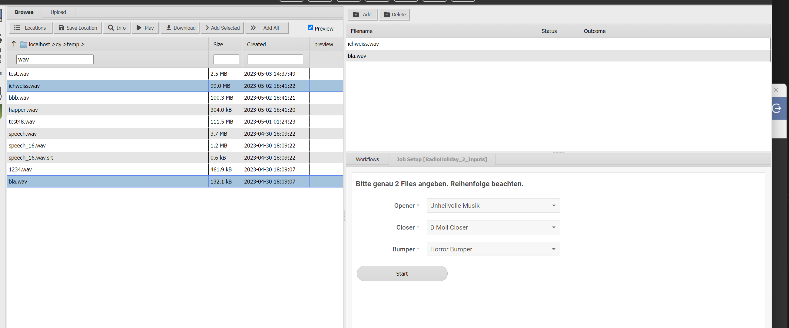

Regarding webinterface submission, i fear you will need to spend a little time to get into it but in my head, from a user perspective the interface could look like this. The user has to browse for files on the left side and select exactly 2 files for the right side. The workflow can optionally present some options to the user (in my example, i present 3 dropdowns that would link to static wav files on the NAS).
This way you can provide some helping text to the user, explaining what he has got to do and in your workflow you would not need to check and search for any files, you would just work with the 2 files the user provided.
