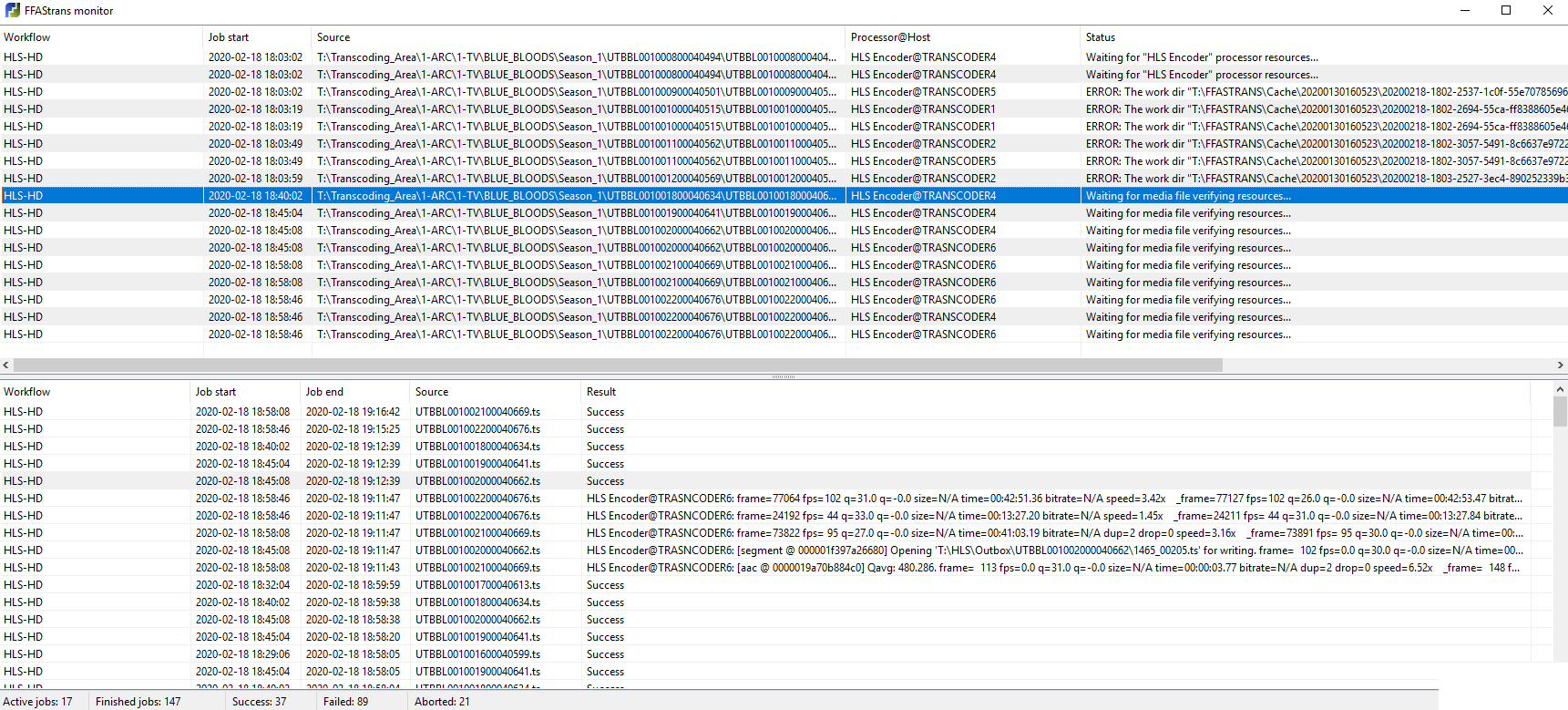

I have migrated to 1.0 but one of my latest transcoding jobs is not working as in previous 0.9x version, the jobs does not seem to finish on the monitor window, although some of them were completed.
Attached i'm sending you the workflow, that was working before, and all the logs, plus a screenshot of the monitoring that have been like this since yesterday.
Also I noticed that some jobs shows up on the monitor as running, they disappear, to come back few seconds later.

Hi dlebrero,
It seem to be working just fine with 1.0.0.1. But you must remember to ALWAYS enclose your paths with quotes. Not sure if this will cause a problem for you and your files in this worfklow but this is just a general rule/recommendation.
Can you please make sure you're running 1.0.0.1 and try again?

I tried adding quotes for all paths on the workflow, but is still failing to remove some of the messages from the monitoring window, I think that is related to permissions deleting those files from the shared cache location, since I cannot edit those files from windows.
Seems that they are either open by another application or locked.
I will investigate further and report back.
