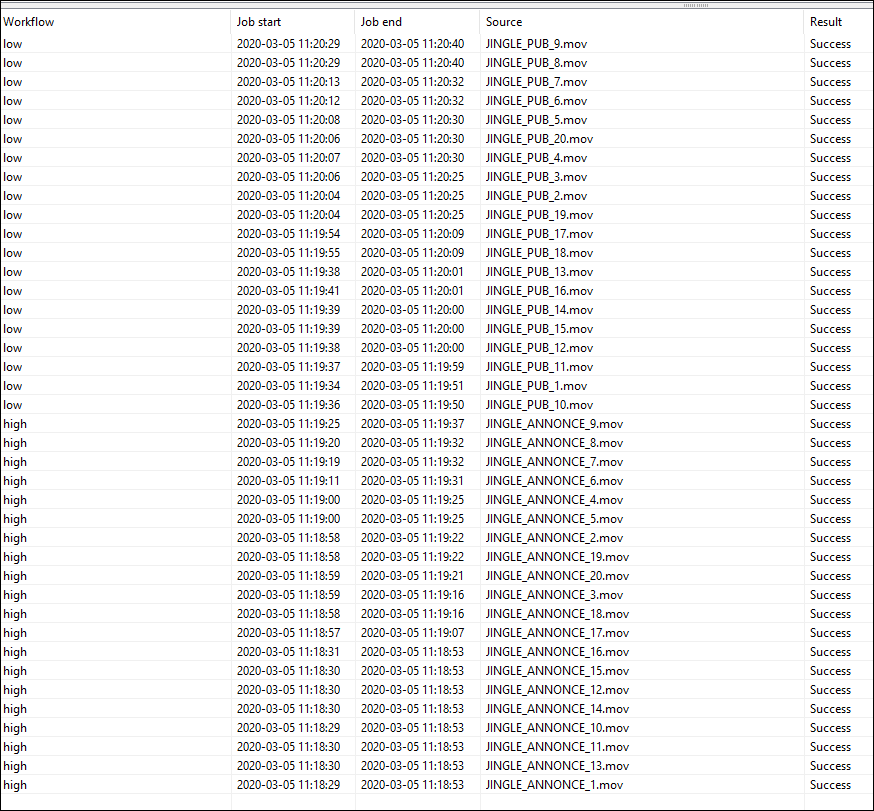

Well I did a test this morning, the test must be done with watch folder cause submitted jobs are always the higher priority :
- FFastrans 1.0.2
- 2 Workflows : 1 with high priority, sleep timer set to 10 / 1 with very low priority and same sleep timer (10) --> the 2 workflows will start at the same time
- 40 files to encode in h264 and deliver : 20 files will be processed by the high priority workflow(called Jingle_annonce_X) / 20 will be processed by the very low workflow(called jingle_pub_x)
- The 2 workflows will start at the same time.
- My maximum active jobs is 8
The result is ok for me, FFAStrans has first processed to the high priority files(all files) then the others.

Ah...there's the answer:
I/we don't user watch folders, everything is submitted via scripts from various processes.
With that knowledge, I can architect something to get what I need.
