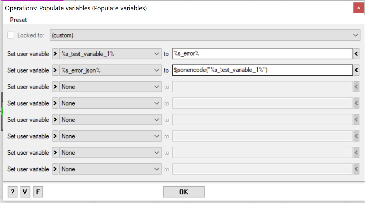

Hi cripsyjones,
If your literal string does NOT contain neither double nor single quotes it really does not matter. For example:
"%s_my_variable" is just as good as '%s_my_variable'. On the other hand:
"my "string" is cool" and 'my 'string' is cool' will NOT work.
If you are usure or you string contains mixed quotes, you should store the string in a variables before using it in a function.
Hope this helps.
crispyjones
Posts: 110
Re: Functions question...when to use double vs single quotes?
Post by crispyjones »
Because this is an error reporting block it's hard to guess what might be in the %s_error% string. I tested your solution for mixed quotes, I was skeptical, but it worked (at least on my error containing double quotes)! Thank you.
