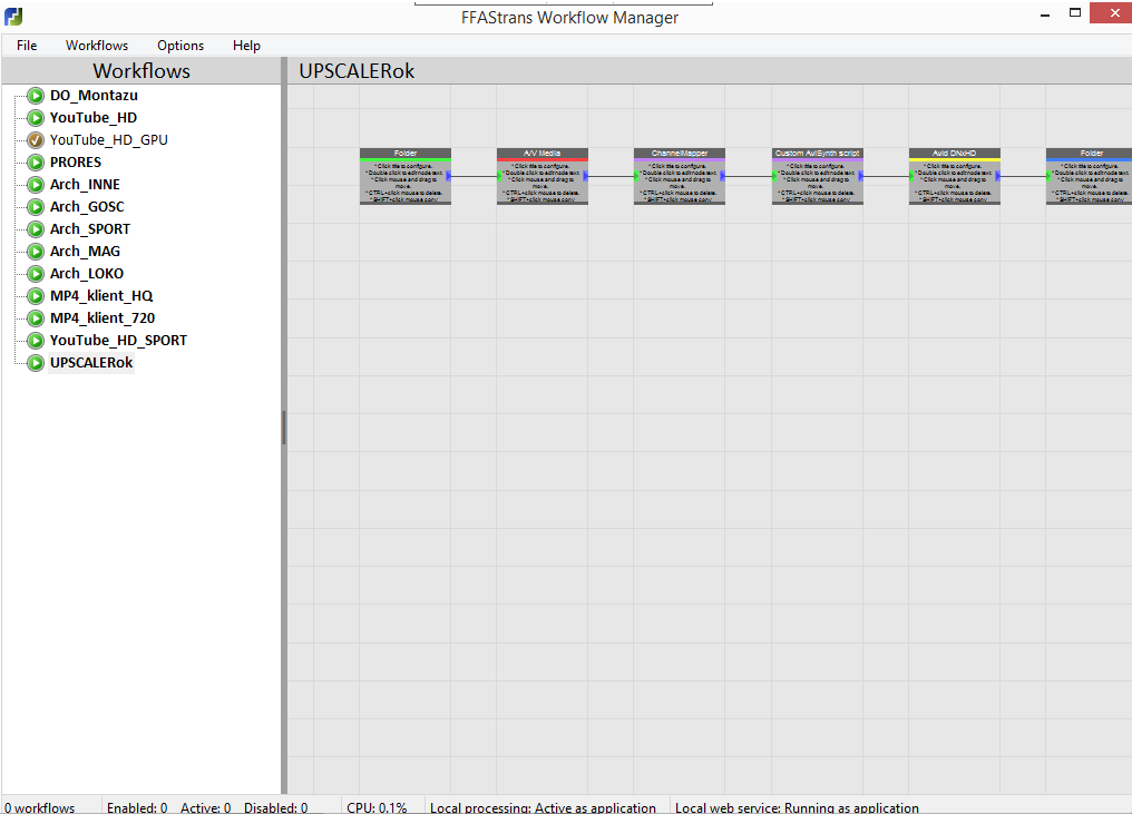

How do use this avisynth plugin: https://github.com/Alexkral/AviSynthAiUpscale with ffastrans?
At this moment my script looks that

Workflow window is in attachment.

This my stupid fail. I search lot's of options(thats why i have this dlls in command line and other strange things), why script dosent work. And i found... It's in workflow one processor over other processor and they hasn't connected...
