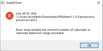

Hello there!
The Color Conversion node with custom values returns an error message.
"Line 26735 (File...processors.a3x)" (See attachments)
It does it even with the "default' value of 0-16 / 255-235.
I wanted to make a custom broadcast safe filter.
Let me know if you have a solution.
Thank you very much!
Re: 1.1.0.2 - Color Conversion - Custom Not Working
Hi philthewiz2, thank you for using FFAStrans and welcome to the forum!
Or at least thank you for TRYING to use FFAStrans ;-) I'm sorry about this bug but it has now been located and corrected. While waiting for the new version you can create a custom avisynth script instead.
m_clip = ConvertTo8Bit(m_clip)
LoadPlugin("%s_ffastrans_dir%\processors\AVS_plugins\ColorMatrix\x64\colormatrix.dll")
m_clip = ConvertToYUY2(m_clip)
m_clip = ColorMatrix(m_clip, source=2, dest=0, inputFR=false, outputFR=false, clamp = 0)
m_clip = Levels(m_clip, 0, 1, 255, 16, 235)
m_clip = ConvertToYUV422(m_clip)
This script is the exact equivalent of using the preset for full range to limited (TV).
Again, sorry for the inconvenience.
