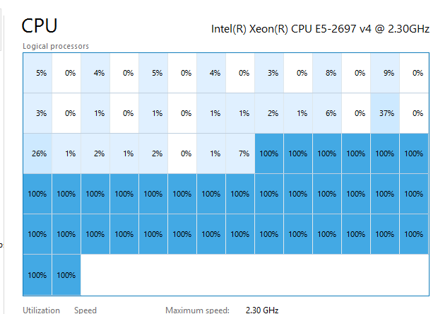

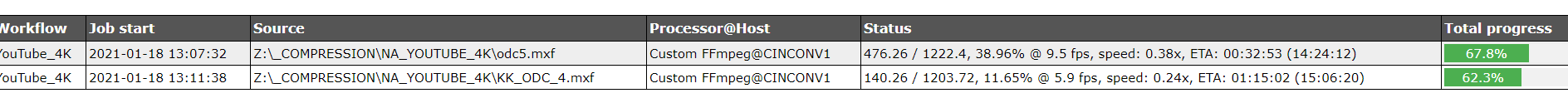

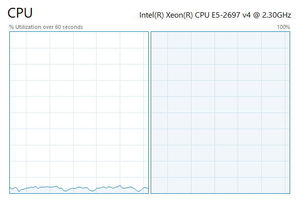

When ffastrans transcoding few files on same time (in one workflow), then uses only one NUMA node.
Is possible to run one video transcode on numa node 1, and run next video transcode on numa node 2?

luckily, i got some new servers with 32 Cores now and what i found out is that your problem might be less connected to NUMA Nodes but to processor groups instead. In my HP Server DL380 Gen10, i found some NUMA related option that when set to "Cluster", it would force windows to Split my 64 logical cores into 2 groups while i expected to have only 1 group.
So, your goal is always to have only 1 processor group (unless you run with more than 64 cores, in that case let's continue the discussion). You can e.g. simply disable Hyper-Threading as there is no benefit from it for transcoding anyway.

Sorry. I have lot of jobs and i forgot about this thread :/ At this moment ffastrans is base transcoder, it has 5-6 jobs in one time. CPUs is allways loaded to 100%
