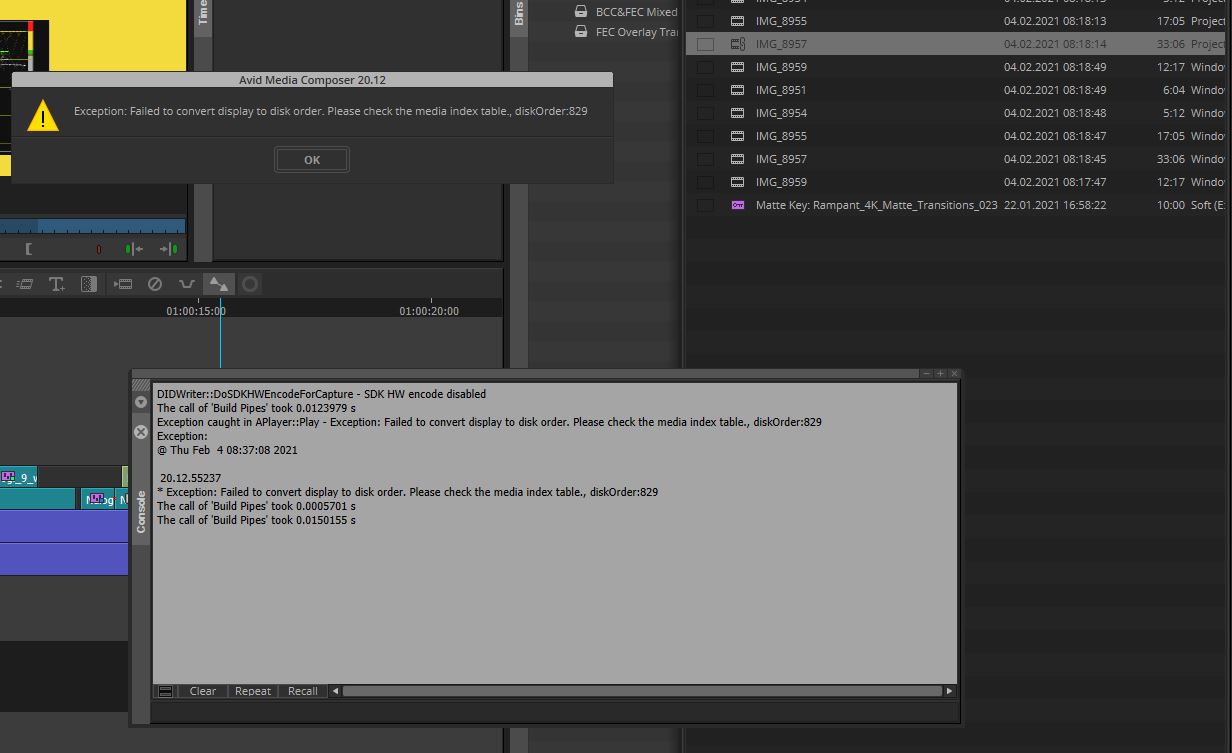

Hello! I made simple workflow XDCAM-HD -> Folder just for convert multiple sources to edit with Avid Media Composer. It works great but today I found some types of files that not encoded correctly for Avid consolidate process:
I found at Avid site this old article:
The editing application uses source index tables now to ensure that this media is wrapped correctly. If the media is wrapped correctly, the media will play back correctly. If the media is corrupt, the media will not playback and you will receive an “Exception: Failed to convert display to disk order” error.
I changed wrapper in processor to MXF (BMX) and mov, interlace, audio tracks , but result is same.
These encoded MXF files can be played by viewers, can be linked, viewed and imported by Avid MC, but can not be consolidated. The CONSOLIDATE process in Avid (as I think) is fast unwrapping tracks from source MXF to MXF OP-Atom to avid media folder. And here is the problem.

Thanks for reply! I tried bmx.mxf - error was the same with "media index table". But cgop.mxf was consolidated fine! I did not write correct previous post. My encoded mxf was available to link and play in Avid but cannot be consolidated and imported. And if I play that in Avid to 33:04 (2 frames to end) - the same error is showing up! We have 2018.12.10 perpetual license Avid and up-to-date last 2020.12 version. Both shows the same results and errors. Different PCs.

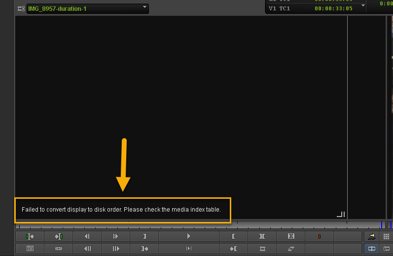

Re: Some encoded MXF files not compatible with Avid consolidating
Hello 3dSasha,
Yes, I have this problem regularly unfortunately. Go to the end of your file in Avid MC and you will see the message (screencapture).
As @encodem said, there is a "structural" issue with this kind of files. While waiting to find out the problem, here is a simple workaround :
Link your file in a bin, double-click to load it into the player. Mark your clip (in-out) and move back your output point from 2 frames (you select your entire master clip except the 2 last frames, don't worry these 2 last frames aren't in your original file). Make a subclip with your selection and consolidate it WITHOUT any handle !
Hope you understood.
