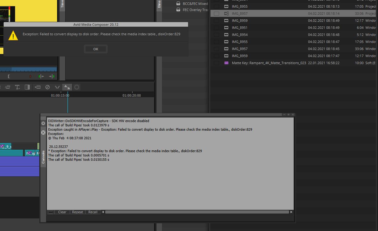

Yes, I have this problem regularly unfortunately. Go to the end of your file in Avid MC and you will see the message (screencapture).
As @encodem said, there is a "structural" issue with this kind of files. While waiting to find out the problem, here is a simple workaround :
Link your file in a bin, double-click to load it into the player. Mark your clip (in-out) and move back your output point from 2 frames (you select your entire master clip except the 2 last frames, don't worry these 2 last frames aren't in your original file). Make a subclip with your selection and consolidate it WITHOUT any handle !
