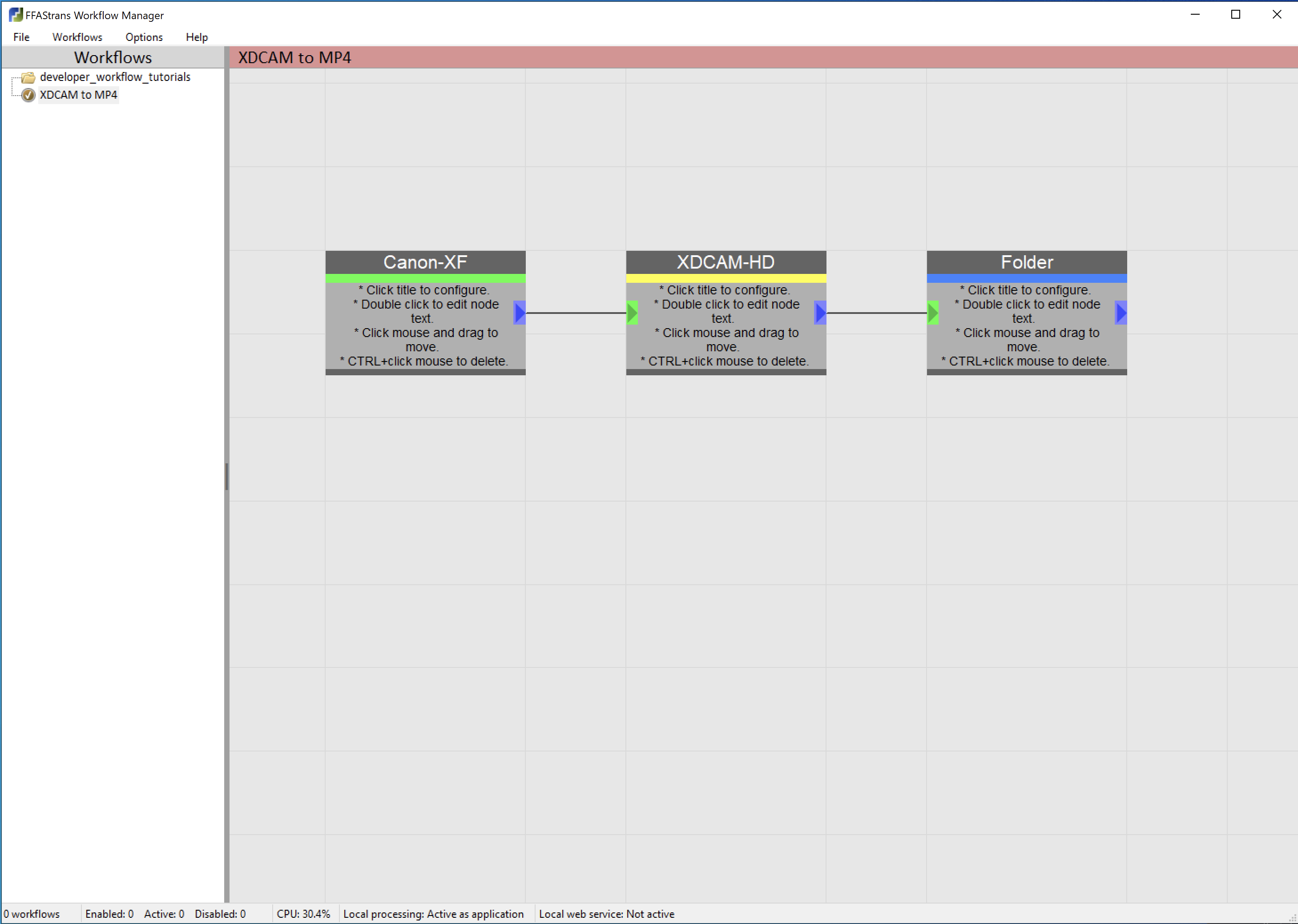

first of all thanks a lot for your amazing software, i'm finding a way to combine multiple spanned mxf from Canon XF card to a single Xdcam 1080 25p mxf file, here below my simple workflow:
Screenshot 2021-04-15 at 10.56.42.png (244.58 KiB) Viewed 10130 times
As you can see, i'm using a Canon XF node as monitor folder, and an xdcam encoder node that convert the files in XDCAM MXF, but when i copy CONTENTS folder of the card, in the Canon XF watch folder, process starts but the node pass to the encoder node only the first mxf in the list, at the end of my workflow, in the delivery folder i have only the fist mxf file and not an mxf with all the mxf files joined on it.

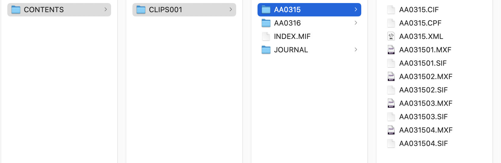

this is an example of my folder card structure:
Screenshot 2021-04-15 at 11.23.52.png (121.05 KiB) Viewed 10130 times
I don't understand what I'm wrong

yes if i use a classic monitor folder with "recurse" option, the process starts but at the and of workflow i have one mxf for each file processed, what i need is a way to merge all the multiple spanned mxf ( as you can see in the second screenshot, contained in the folder AA0315 and AA0316) that i have in the source Canon Folder.
if i understand correctly when you use a Canon XF as watch folder, all the multiple mxf file contained in the folder are merged in a single mxf file and and passed to the next node, but in my case only the first one of each folder is passed to the encoder node, for example of the files in the screenshot, only the AA031501.mxf is processed, all the other ones are ignored.

As you can see in my first screenshot, after the Canon XF watch folder I have directly inserted the transcoding node, is this correct ?
just to understand, it's the node of the Canon XF watch folder that merge all the spanned mxf clips into a single one mxf, or after the watch folder I have to add a particular filter node ?
