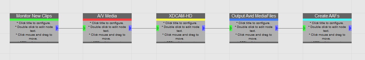

Workflow:

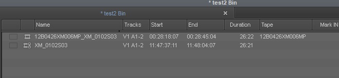

The immediate issue I've spotted is the fact that there is an additional frame added to the duration of the transcoded clip, which doesn't seem like a big deal but it can cause issues for our conform process. The other problem is the timecode of the transcoded clip doesn't match that of the original when we link to it in avid (see screenshot of the avid bin below). Anyone know what could be causing this?

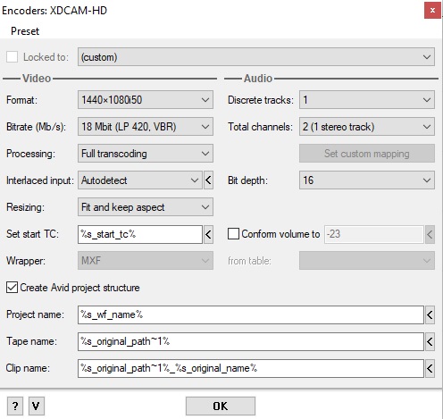

This is a screenshot of my XDCAM-HD encoder settings. The "set start TC" is default to %s_start_tc% so i believe this is correct for using the original clip timecode right?

First of all, you're right, the timecode variable set in the XDCAM node is correct, in the sense that %s_start_tc% will always return the timecode of the original file.
If it doesn't find it, then it will always revert to 00:00:00.00
Now, in your case, by linking the clip you get 11:47:37.11 while FFAStrans returns 00:28:17 which means that it has found a timecode in the original file, but it differs from the one AVID picks.
