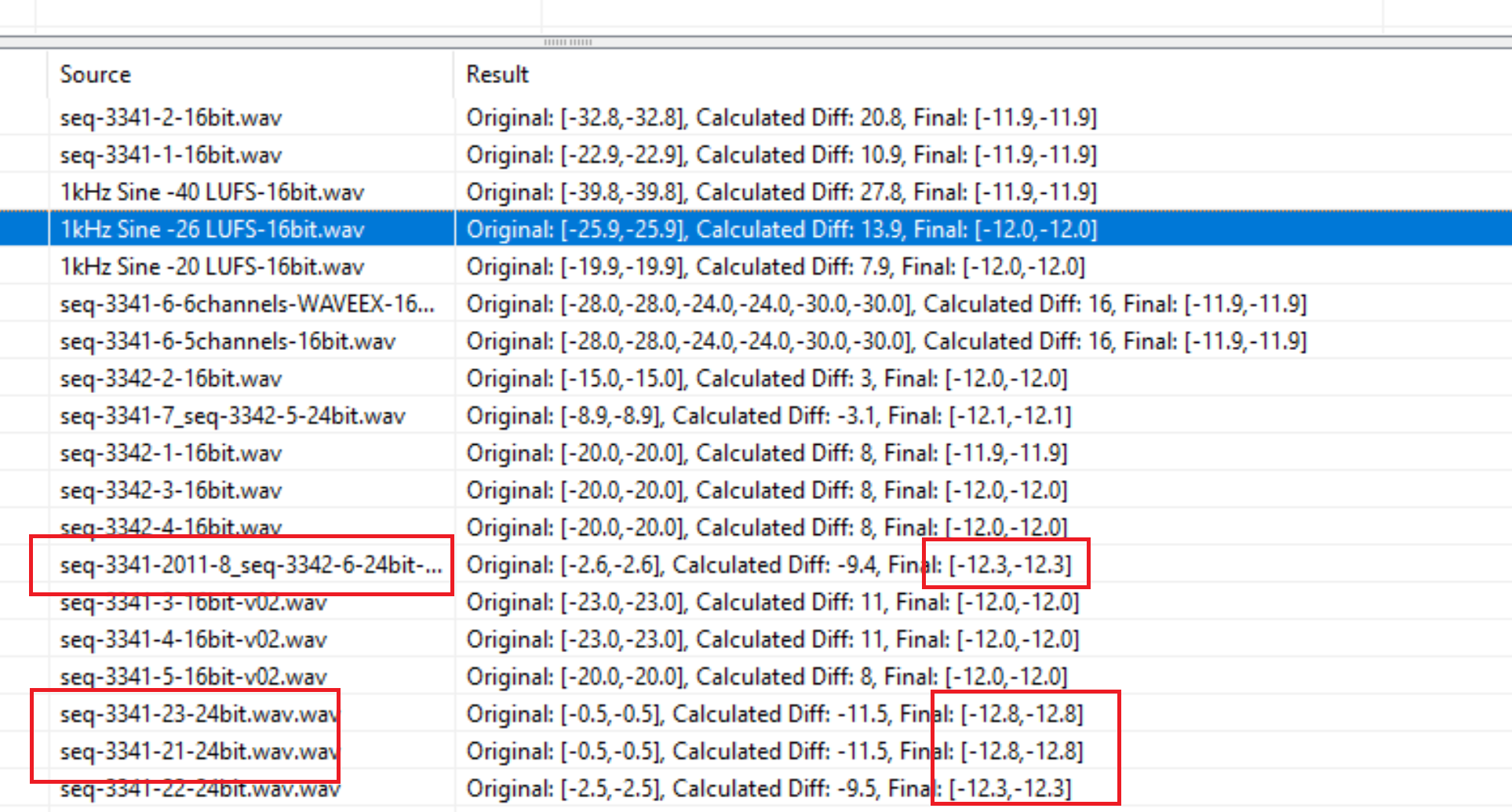

But, beware... at least using the freely available EBU loudness sample files, above workflow also produced some strange values:

BTW I guess the values below -12, such as -12.3 are fine. They just should not go higher than that. But anyway this is just amazing what you can achieve with FFastrans.
