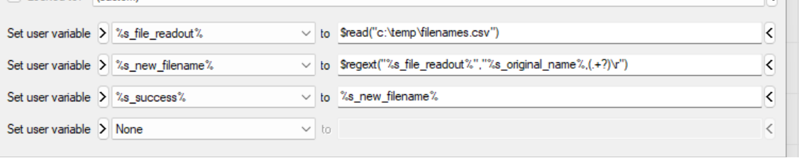

thats pretty simple, as long as you can guarantee that it is the full original name in the csv, correctly written including upper/lowercase being correct.
in that case, we can just search the line that contains the original name in the csv and extract the part after the comma:
The regex i use for finding the line and getting everything "from comma to the end of line":
$regext("%s_file_readout%","%s_original_name%,(.+?)\r")
Note that this regex assumes you created and saved your csv using windows, which puts a \r\n at the end of every line. If you dont have \r in the file, you could replace \r by \n to indicate line ends.
when you have the part of interest, you can use a simple replace to calculte the full final path:
%s_new_full% = $replace("%s_source%", "%s_original_name%","%s_new_filename%")
and finally use a cmd processor to move the file:
cmd /C "move "%s_source%" "%s_new_full%""
Note that i use move instead of rename here because "move" works on all OS and the windows stock "rename" command does not accept full target path.
For Error handling:
1) check if we found something in the csv by checking if s_new_full is not empty
2) probably set s_success to %s_new_filename% at the very end, so you can see the calculated name in the job monitor
3) cmd processor with move cmd should fail if the target exists

thanks for your help, I'm probably doing something wrong because my workflow doesn't work, instead of renaming my 3 files, at the end of the workflow I have only one .txt file, probably the new file names are not read in the csv file, and the workflow creates only one file which overwrites the two more.
for example I don't understand where I have to put this part of the workflow
CODE: SELECT ALL

ring4life70 wrote: Tue Dec 27, 2022 4:57 pm probably the new file names are not read in the csv file,
OK so i'd really like to get you to a point where you are able to debug such stuff on your own.
Are you aware about the options to use either populate proc and set s_success to some variable value OR using the write text file proc that you can use for investigating the actual value of any of your variables?
When we build a workflow that constructs some variable, we first always disconnect first the rest of the workflow and as a very first step make sure that our desired variable was constructed correctly.
If you have troubles with any of that, please start by checking out the tutorial thread, there is a section about how to debug variable values using the write text proc:
viewtopic.php?f=5&t=849#p3566
ring4life70 wrote: Tue Dec 27, 2022 4:57 pm and the workflow creates only one file which overwrites the two more.
Sorry i did not pay attention to the specific behaviour of windows move command. It does in deed overwrite existing files by default (who invented this?). If you don't want to do that, your workflow has to check if the file exists.
Example workflow with some error handling:
emcodem_rename_use_csv.json
(6.33 KiB) Downloaded 916 times
One more thing to mention:
The last line of the csv is special because it might usually not contain a newline character at the end. So the regex i proposed above would not be able to work with the "last line of the csv". You could just put a newline after the last line or insert some bogus line at the end but we could also handle that using regex:
$regext("%s_file_readout%","%s_original_name%,(.+?)\r|%s_original_name%,(.+?)$")
